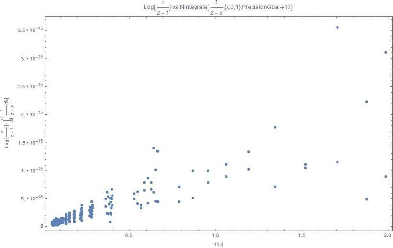

Thanks for your help. I wonder whether the issue comes from Log[z/(z-1)]. To test it, I evaluated two equivalent expressions with Mathematica making use of the following identity
ln(z/(z-1))=∫^{1}_{0} 1/(z-x) dx
Ideally, the difference between left and right hand sides should be zero, but Mathematica tells me otherwise, as shown from the attached figure.
Can you explain to me why as usually we would assume the elementary functions have been extremely well carried out as built-in functions and should attain the highest machine precision?

Thanks, I had been clicking on the figure icon on top of the textbox, and it really didn't do what I wanted. Here is the figure showing the two otherwise equivalent expressions have error bigger than machine precision and has a strong dependence on the input parameters.
I understand the precision of the output from the built-in functions will have a dependence on the input parameters, but they should do at least what we ordinary people can achieve. Obviously if |z| is small, we should be able to make it more accurate by using taylor expansion than what gfortran
returns us.
One thing I might mention is that the lack of accuracy can be in NIntegrate as well as it might fail to reach prescribed precision goal I set. I have written to Mathematica to see whether there is way to detect the condition satisfied or not.
Have you set WorkingPrecision as well as PrecisionGoal?
