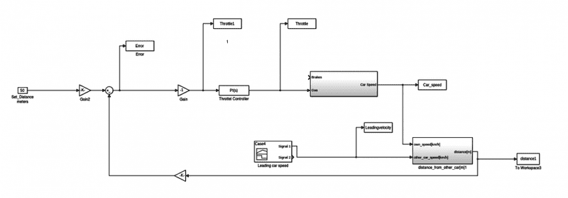

I have a model of car, my aim is to make a simple model of adaptive cruise control. The only input to this model is a user set distance (range 2 to 50 meters), this is the distance that our vehicle should maintain between itself and the leading vehicle. I plan to control this using throttle and brakes, presently I am controlling only throttle using PI controller, and hence I am able to follow a car which moves with a fixed velocity and does not slow down in middle ( the leading car should not slow down because the following car does not have brakes, so its not possible to slow the following car).
Now I want to introduce brake controller, and I need some suggestions or guidance with respect to how can I have two controller in parallel i.e one for throttle and one for brakes.
Note: I am doing all this using Simulink.
You cannot. The PID-controllers will start a fight.
Use one PID-controller. Then make some decision-making proces: If the output of the PID-controller is negative: use the brake. If it's positive: use the throttle.
You must have some "dead-band" built into this decision, or there will be a fight anyway:
If (output>3%) then throttle = output-3% else trottle = 0;

If a D-function is needed , I'd recommend inserting this function in the feed-back path. Otherwise the tyres of the car will be worn very quickly. In your model you must consider what "gas" and "brake" means physically. It would clarify what you are doing if you call the inputs "positive force" and "negative force" instead. Then it becomes clear that the gas/brake/speed block includes an integrator. Also the "distance_from_other_car" block includes an integrator. So now you have three integrators in the loop ( alert ).
You will need two D-functions in the loop, to keep the the closed loop stable.
In your model, you have this label: "Error". What kind of error: position/velocity/force? For your own sake: Write what is meant so you know what you are doing.
If I were to build a controller, I'd make up an inner speed-control-loop and an outer distance-control-loop. Then the controller, as a whole, would be much more robust. Having "tuned" the speed-controller, it's "a piece of cake" to tune the distance-controller. You won't have as many problems with "wind-up" in your integrator ( PID-function).

Does your block diagram reflect that? The print on your drawing is too small to read.
Look up "Three Element Control"
Likes donpacino
What is that model you posted?
It's too small to read the text.

You have attached the speed controller two times. What about the position controller?
Anyway I see that you are using some program (Simulink?) in where continuous and discrete signals are mixed up ( PI(s) , z-1 ). It's indeed a clever program. I hope it knows what it is doing. Discrete controllers (digital controllers) are very clever to handle time-delays, as delays are already "built in" the controller because calculations include calculation delays. But earlier you wrote that your PID was analog, so stick to that. A time delay of T sec. could be adapted by ( 1 / ( s + T ) ).
Your plant has two different tranfer functions included: Brake ( B(s) ) and throttle ( T(s) ). You could insert a prefilter before the brake = T(s)/B(s). Then in theory the brake and the throttle should act identical on a signal from your PI, because T(s)/B(s) * B(s) = T(s).
I would measure/calculate the transfer function as for the throttle. Then I would calculate a PID so that the damping was exact = 1 ( just an example). Having done so I would split the PID into a PI filter (forward) and a PD filter (backward). The characteristic equation will not be changed due to this split.
The transfer function, T(s), should look something like:
speed(s)/throttle(s) = k1 / ( s2 + k2*s + k3 )

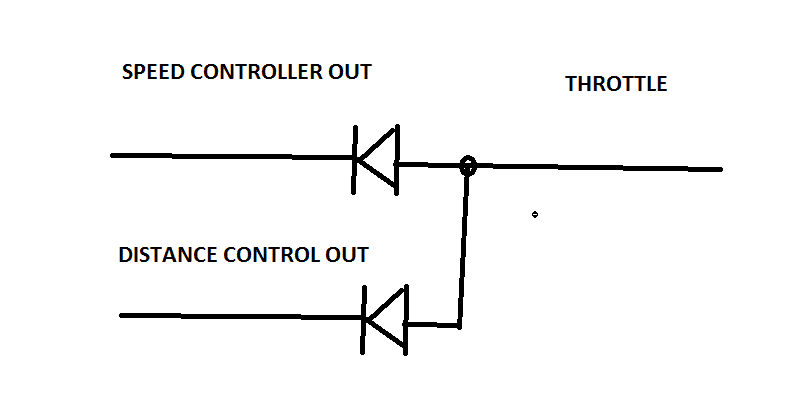

Hi,
I have a speed controller and a distance controller. The distance controller has speed controller as inner loop. Now I want to limit the speed to which my car can follow the leading car, any idea on how I could achieve it? I am trying to use a switch in distance controller where the input to inner loop changes depending on the max speed limit. Will post this pic later as am still trying to get it to work. Any suggestions would be appreciated.

You can 'wire OR' distance and speed controller together. For throttle it would look something like this:
For the brake, the diodes are the other way around.
Likes Gauzi
Thank you very much for your help :) I managed to solve it, I was not using proper saturation parameters.
