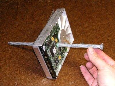

This is my method for preventing data retrieval.
I do not recommend this technique if you are planning on returning the computer.

"I swear that nail was there when I bought it"
