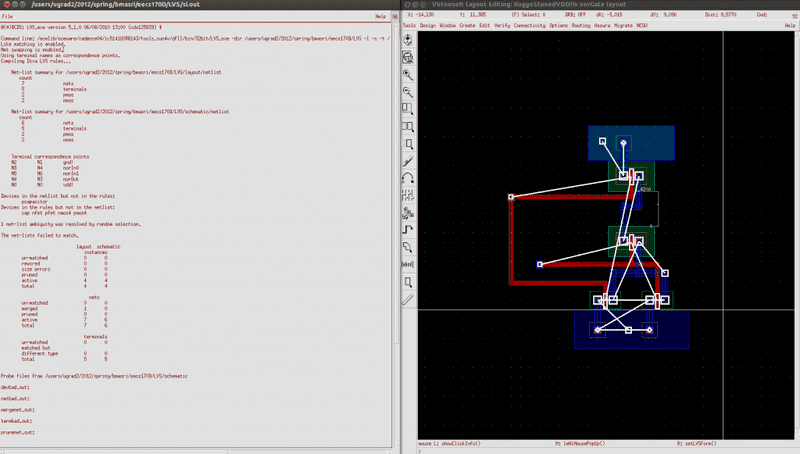

Hello all. I have been at this layout all day and I have seriously had it. So half way through the day I realized and confirmed that it is the source to body connection of the middle pmos that is missing (i think), the problem is I don't know how to make that connection! Simple, but I have tried every google search combination possible, there is absolutely nothing about this online! I will attach my layout and the netlists for comparison. Please any help will be much appreciated.
PS: I know my layout is poorly constructed.
EDIT: Forgot to mention, DRC is successful.
You simply need to extend the N-well (the green region, I think) in which the middle device sits until it touches the N-well in which the upper device sits. Since the upper N-well is contacted, this will contact the middle well also. As it stands, the middle N-well is floating. Alterantively, you could add another N-well contact region (the blue rectangle at the top) off to the right of the middle device. Make sure the middle N-well is tied to Vdd, not to the source of the middle device. Does this make sense?
Likes 1 person

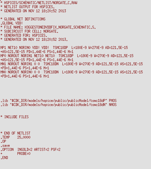

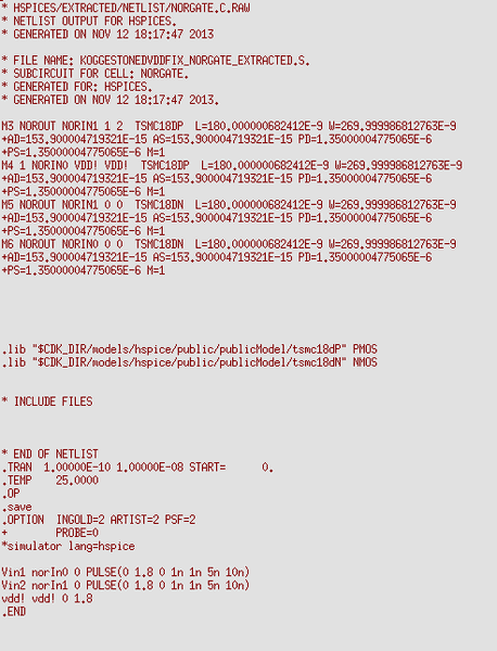

Thank you so much for your reply. Finally an answer. In my schematic that middle pmos has its body connected to its source. If I extend the nwell of the middle pmos to the top pmos, won't that connect the body of the middle pmos to vdd? Or is the nwell not the body of the pmos? I will try to implement what you have said in a couple of hours. Once again, your help is much appreciated.
Your schematic should not have that PMOS body connected to its source. In logic circuits, the PMOS bodies should all be connected to the most positive point (Vdd), and the NMOS bodies should all be connected to the most negative point(Vss), otherwise you run the risk of forward biasing the S/D junctions.
The N-well is the body of the PMOS devices. I suggest you connect those N-wells together and correct your schematic.

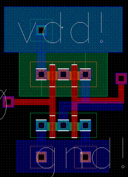

I just overlapped the drains (just as you said)! It Worked! Check this out! LVS AND DRC PASS! I went from that ugly thing in my OP to this beautiful creation : )
Thank you all for your help.
perplexabot said:
Thank you that fixed my error. Finally!
Now that looks like a proper NOR gate!
Only a couple comments. Typically you wouldn't use long poly runs for your A and B inputs because poly is slow (high capacitance and high resistance compared to the metals).
How many metals do you have in your process? Typically you would try to make odd metals go in one direction and even metals go in the other. However that isn't necessarily a issue here because logic cells don't have to be routed out to the edges. In a practical digital circuit the logic cells are mashed together and then the metal routes come in from higher metal.
Looks good though. Those are minor suggestions. :)
