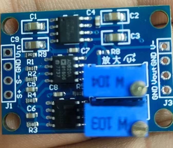

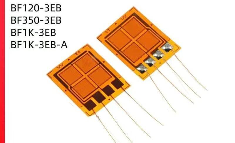

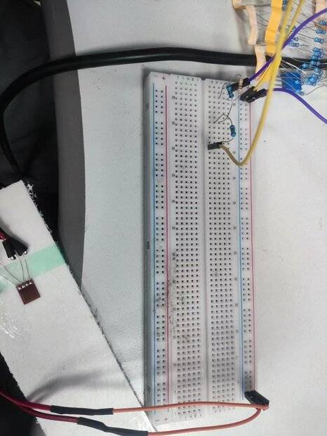

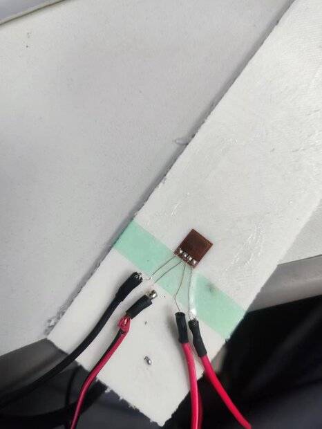

recently i bought this strain guage where vender said it is 4bridge, i am not sure how to connect this in wheatstone bridge , i have 120 ohms resistors, and 120ohm strain gauge.
please need guide thank you.
From the look of the image, I get the impression that those four areas are actually the four resistor elements of a bridge. Put volts across two terminals and measure the volts across the other pair, which should be around Zero with the gauge undistorted and balanced. Do you have a data sheet?

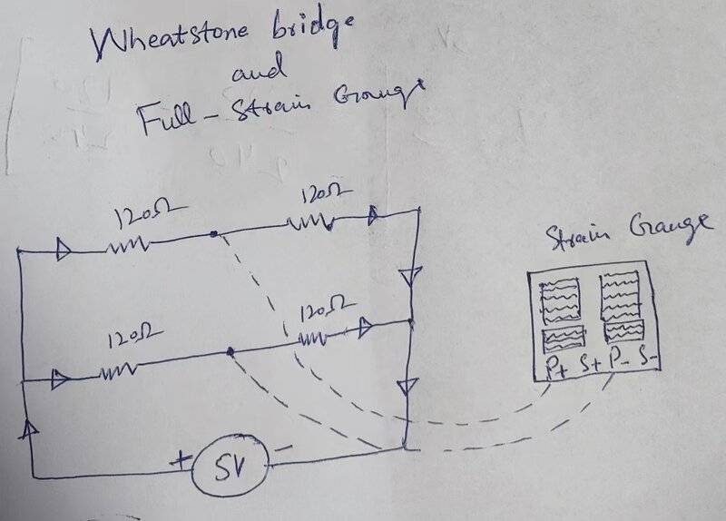

thank you for reply, they did not have anything, from internet i found this
Looks ok to me. Wire it up and hit it with about 5V (arbitrary) and see what happens.

i have AD620 FOR AMPLIFICATION, i connect strain guage with breadboard and arduino to get voltage output from arduino, arduino is not showing anything, please can you see the specimen principal stress direction and strain gauge orientation and selection
the strain gauge heat up when supply voltage but reading not coming out from arduino i think i made wrong in orientation starin guage

The voltage to the bridge power supply terminals need only be about 1 volt.
For a healthy symmetrical bridge, the resistance between the two signal output terminals, should be the same as the resistance between the two power terminals. If that is not the case, then the bridge has been damaged.

Three volts should be OK, but heating the gauge can be a problem with higher voltages.

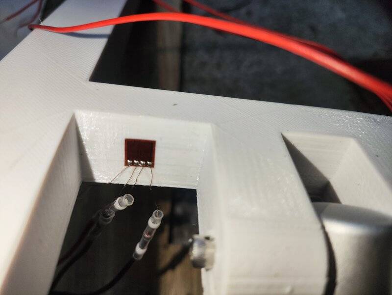

In an earlier picture, I see the strain gauge is glued onto a white structure. Maybe the connections you have used, or the orientation, is such that you get cancellation of the resistance changes due to the strain. Can you place the bridge gauge on a square of material for experimentation, until you have the electronics working?

thank you for reply, you mean i print square shape 3D and put new bridge on it?
No printing required.
Just stick a bridge onto a scrap piece of flat material, something you can bend with your hand while you experiment with the electronics.

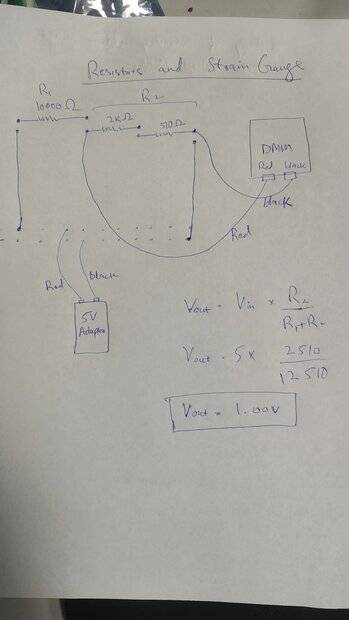

have tried to manage 1V using 2(1.5k) and 10k , i am thinking like this not sure i am right or wrong , appreciate your valuable time and guidance
the out from voltage divider circuit will go to breadboard down relay, and the strain guage + and - will connect to this relay
Are you using the diagram in the link I quoted? Which is R2 and R1 and what is your supply voltage? Show your working how you calculated 1V out? Your output volts can be obtained by many different values for R2 but consider what happens when you connect the bridge across the output of the potential divider, the resistance ratio changes a lot (current will flow through the bridge). The bridge presents 120Ω and you need to consider this because it appears in parallel with R2 so you need a different R1. Google with "using potential divider to change supply volts" and you'll find loads of discussions which show you what I mean. If you have a box of resistors then your bread board will make this easy to experiment with.
A 1V voltage regulator may be better because the output volts do not depend on the value of the bridge resistance.

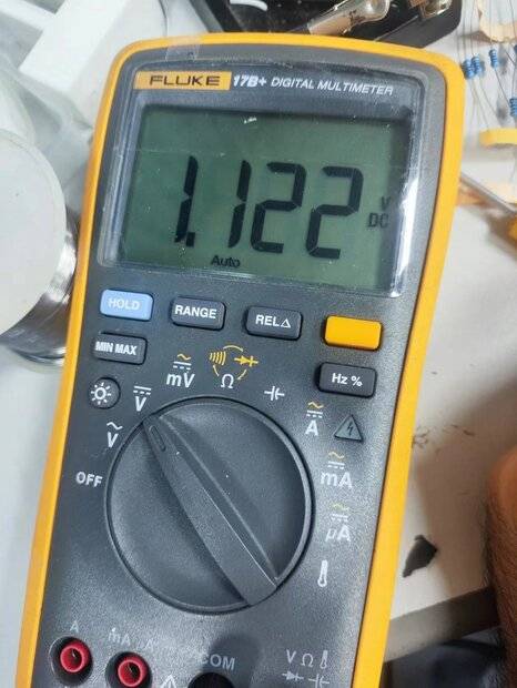

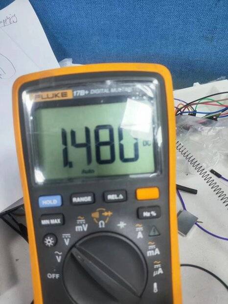

the other possibility to have 1 V as shown by calculation and DMM

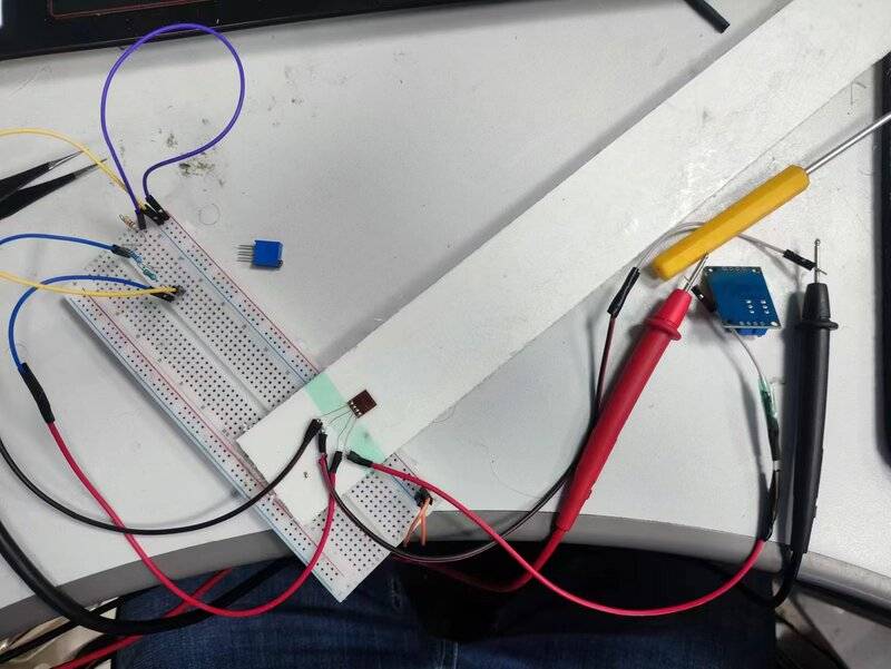

I have tried to get reading from wheatstone bridge , the beam not bend just in stationar position , although the reading from DMM not stable ,
Voltage output from wheatstone bridge
Voltage reading from AD620 output

That 1.04V looks ok. It will change when you hang the bridge on the output? That's because you have changed the effective value of R2. Starting with that 120Ω, what R1 value is needed to get 1V? Insert new resistor and check that you get 1V.
Connect DMM across the other two terminals of the bridge. You should get low value (zero if perfectly balanced). Flex the bridge and see change in DMM volts

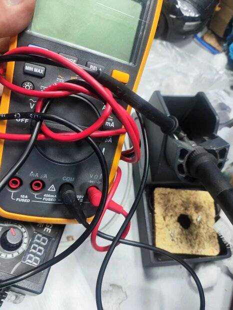

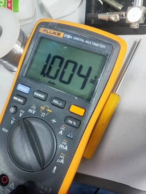

several things i confirmed .
1) the voltage is receiving by bridge is 1V
2) the output from wheatstone bridge(DMM) is fluctuating a lot , never stable going to very high value and drop sudden.
3) the voltge in DMM is between 0.004-0.006 , mv fluctuates a lot

Have you modified your potential divider resistors? If not then there is something wrong with your connections. The ratio of the 'pot' would be 120/10120.
Have you used your DMM to find the resistances between (all) the bridge terminal pairs? What do you get?

  • Vin=Vsupply= supply voltage= 5V
  • Vout=Vbridge=1V
  • R2 = 120 ohm ( Strain Gauge resistance)
  • R1 = ( ( Vsupply - Vbridge ) R2 ) / Vbridge
  • R1=(( 5 - 1) 120 ) / 1
  • R1 = 480 ohm
  • Current Flow through strain gauge Vbridge=IR ( Guage Resistance(R) =120 ohm , Vbridge= 1V)
  • Vbridge / R(Gauge Resistance) = I
  • 1 / 120=I
  • 0.008A
The following calculation is to find Current through strain gauge and R1 needed ,
To get 1V , i need R1 = 480 ohm ,
i have interest in both areas( mechanical and electronics)
i have confusion about wiring
  • #39
sophiecentaur said:
They are not 'in series' on the bridge. They are in series / parallel - hence the 120 total.
please can you check like this , before attaching strain guage , the DMM show zero but when i attach strain gauge ( replacing one resistor in brdige with guage) it show 1.480V while beam is stationary
  • #40

what does that diagram mean? Look at other schematic diagrams. You will notice that connecting wires are actually joined together (often with a dot). Those 120Ω reasistors are not joined to anything so they don't "do" anything. You should try to stick to the conventions if you want to make sense. Have you seen a diagram of a bridge circuit? The power connects across one diagonal and the meter connects across the other diagonal. Your picture shows none of this.
PS the way you actually connect things together and where the wires go is best shown by a conventional circuit diagram. Your breadboard version means nothing to anyone else but you.
Likes Micheal_Leo

please fine the attached conventional diagram
  • #44
Ahh!! I see what's wrong. The four strain gauge resistors ARE the bridge. No external 120Ω resistors are needed. (This is a great example of where one should start with a proper diagram; it can save a lot of wasted time. :smile:
  • Love
Likes Tom.G and Micheal_Leo

yes sure , please can you check this reducing the voltage to 1V conventional diagram
  • #50
You can check this yourself, actually. Show the workings of how you came to this circuit. What would the R1 be and what would the R2 be? The resistance of the bridge will affect how things work, remember.
Note: I will not just give you the answer because that won't help you for next time.
Likes Micheal_Leo
