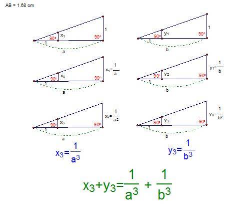

given :AB=1 and ,CD=a, EF=b
Can you construct a segment with length =$\dfrac {1}{a^3}+\dfrac {1}{b^3}$
Mathematics news on Phys.org
the diagrams are not scaled
