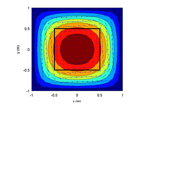

I need to write ampere's law (differential form) in the form of Laplace equations / Poisson equations and then solve them numerically using Matlab.
Del x H = J
pls see my attachment
I need help from someone who is good at electromagnetics, and also have some numerical programming background.
Thank you very much for help!
  • equations.pdf
Ok now I have come up with code for one wire..
Now i need to code for two wires!
Any idea how to do that?
[tex]
\nabla \times B=\mu_0J
[/tex]
[tex]
B=\nabla \times A
[/tex]
so then we substitute this into amperes law.
[tex]
\nabla \times(\nabla \times A)
[/tex]
then we use the vector identity to re-write the curl of the curl.
so we get
[tex]
\nabla(\nabla \cdot A) - (\nabla)^2A=\mu_0J
[/tex]
[tex]
\nabla \cdot A = 0 [/tex]
I did this in terms of the B field but
[tex]
B=\mu H
[/tex]
So now we have reduced this to Poisson equation.
On your second post you said you need code for two wires . well the B fields obey superposition so you can just add the field to the other based on distance.
