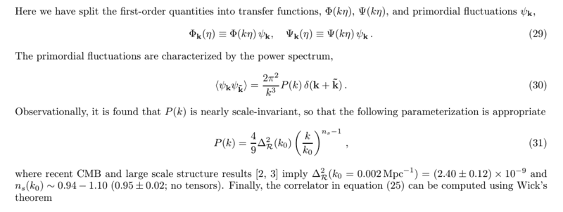

For instance consider calculating this dimensionless quantity:
P= \frac{1}{H^4~~ (GeV)^4} \times \left(\frac{1}{k_0 ~~~(Mpc)^{-1}}\right)^{0.2} ~~(1)
Where H and k are constants. How to convert or choose units to make ##P## dimensionless.
where Mpc##^{-1} = 6.6 \times 10^{-39}## GeV.
The original quantity is given in this paper: [reference][1], equations: (31-33-34), where ##a(\eta)= \frac{1}{H\eta}##, so I considered in (1) only the constants which share by dimensions to ##P##.
Any help is appreciated!
[1]: https://arxiv.org/pdf/hep-th/0703290

(30) and (31) seem to suggest that P(k) has same dimension with k^5. Is it OK? I have not found your (1) in the paper. Where is it ?
