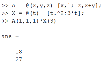

In summary: For example:A = [1 0 2; 3 4 5; 0 2 3];X = [1 2 3; 4 5 6];A(:,1) = X(:,1);A(:,2) = X(:,2);A(:,3) = X(:,3);A(:,4) = X(:,4);This would create the matrix as shown in the image.
