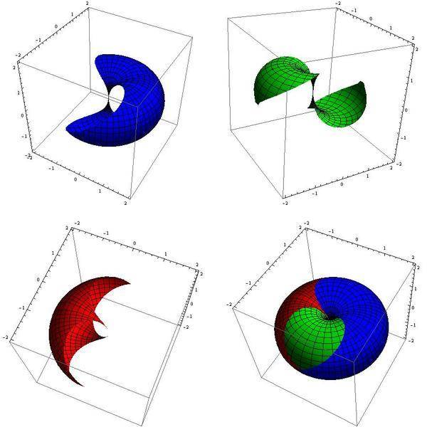

Thanks for replying. May I suggest a possible covering at the risk of offending quasar who told me earlier that a horn torus is not a Riemann surface?
Can we not allow a (normal) ring-torus approach in the limit, a horn torus? In that way we are always dealing with a Riemann surface. Suppose just for the sake of argument we can, then I believe I can cover the limiting case (a horn torus) with three Riemann spheres, each cut along two branch cuts: (infty,-5) and (5,infty). I've shows the blue, red and green surfaces for these Riemann surfaces deformed in the shapes I want below and then their coverings over the horn torus. The point infinity is at it's center and at two points along the perimeter are the points -5 and 5. It's not evident in the picture, but the three colored surfaces meet together at a vertex only at the singular points thus allowing the cycle-3 ramification at these points.
Is this still not acceptable? Note in particular the green surface. Am I incorrect in suggesting I can (continuously) deform a Riemann sphere cut along the two branch-cuts into that shape?
Do I absolutely need to use a ring-torus? No offense to Quasar.

Also, for the record, I don't think the green surface in my plots above is correct. That's ok though. I realize that sometimes you have to go through the wrong ones to get to the right one. :)
