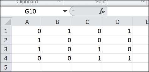

Hi BvU, may be I was not clear in describing what I wish to do. I attach a data that I want to operate on. In this data I wish to conditionally delete any columns that does not contain the value (1) in either row 1 or 2 and any column that contains (1) in row 1 and 2 but contain other (1) in row 4. After the deletion, only columns A and B remain.

I found a simple solution. I highlight row 4 then use the function (find), this will find the value (1) in row 4 and then I delete all columns containing (1) leaving only columns A and B as desired.
Yes, but that's a relatively tedious manual method, will need to be repeated if the data changes, and is subject to human error if repeated. Adel's suggestion of a macro is much more versatile and easily repeatably. If you need this sort of thing very often, you would do well to learn a small amount of VBA.
