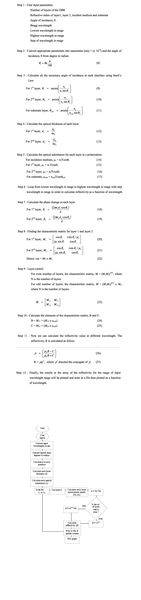

Below is a {MATLAB}code for Bragg mirror. How can I implement the code to create an FP resonator?
Code:

Now solved ! Used different TMM,
