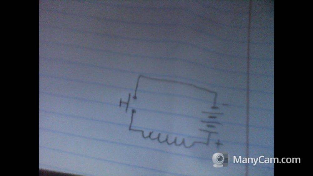

this is the circuit i am planning to use
do you need an oscilloscope to measure the back emf? can that handle high voltage?
That isn't very instructve without
  • Inductance and resistance of your inductor
  • Internal resistance of your battery (three AA cells in series ?)
Once you have those you can predict I(t) when the button is pressed.
V(t) when the button is released is harder to predict

No, unfortunately. While the circuit may appear to be a first-order network (comprising R and L), it also involves capacitance of the inductor windings plus stray capacitance and this changes it into an oscillatory second-order system of unknown parameters but of high impedance. When you connect the oscilloscope probe this adds further capacitance and loading, changing the system from what it was before you connected the oscilloscope. So even though the oscilloscope will display a voltage spike, it is generally going to be nothing like what the spike was before you connected the CRO probe. By this I mean that suppose the oscilloscope shows a spike of, let's imagine, 80V, then without the probe's extra loading that spike may manage to overshoot many times higher, for illustration let's say 300V.

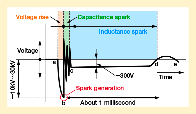

That circuit is a crude representation of an old-fashioned non-electronic car ignition circuit.
The car has a battery, a coil, a switch in the distributor, and a spark plug. It generates spikes of about 20000 volts. In your circuit, the switch and the spark plug are the same thing, and you could generate a spark in the switch.
The picture below shows what you might see on an oscilloscope including the capacitance effects that @NascentOxygen mentioned. Note the total duration of the event is about 1 millisecond.
Source: https://www.denso.com/global/en/pro...rvice-parts-and-accessories/plug/basic/spark/
Likes sophiecentaur

If you just want to suppress the back emf enough to not damage the switch, then here is a starting point Rule-of-Thumb:
Wire a 0.1μF capacitor in series with a 100Ω resistor, then wire the assembly across the coil. The capacitor should have a noticeably higher voltage rating than the battery!
That configuration gives the most effective voltage suppression. The drawback is when/if the capacitor fails as a short, the supply voltage appears across the 100Ω resistor when the switch closes.
Another configuration wires the resistor-capacitor across the switch contacts. When/if the capacitor fails shorted, the load (coil) remains partially powered even with the switch "Off."
