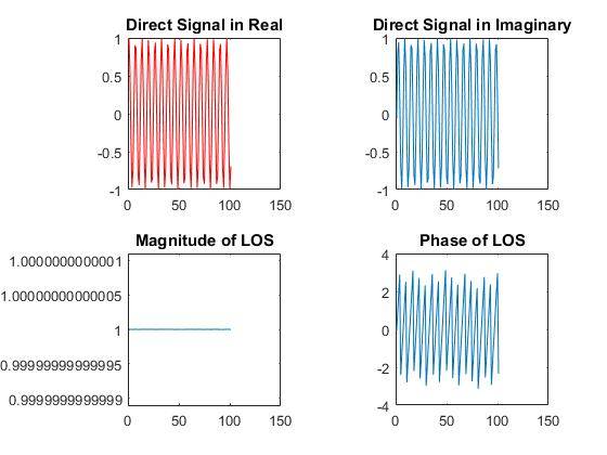

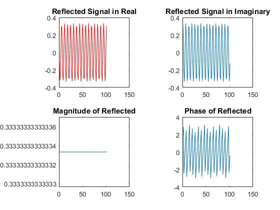

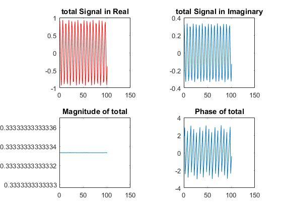

Matlab:
%%%%%%%%%%%% here is my code and plot %%%%%%%%%%%%%%
%% multipath with 2 signals : Direct signal (Light Of Sight) and reflected signal
clear all; %close all
f_c             = 533e6;
speed_of_light  = 3e8 ;                         % m/s
d               = 0.01;                         % distance between 2 rx antenna 10cm
lamda           = speed_of_light / f_c;         % wave length
k               = (2 * pi) / lamda;             % notation for electro-magnetic
w               =  2 * pi * f_c;
a               = [1 1/3];                      % attenuation
x               = [-d/2  d/2];
y               = [0  0];
alpha           = [0   pi/2];                   % turn every time by (pi/2)
tau             = [0  0.1e-6];                  % time delay
t               = 0 : (pi / 100) : (pi * 1);
N_path          = length(tau);
% %%%%%%%%%%%%%%  simple calculation %%%%%%%%%%%%%
a0      = a(1);
a1      = a(2);
x0      = x(1);
x1      = x(2);
y0      = y(1);
y1      = y(2);
tau0    = tau(1);
tau1    = tau(2);
alpha0  = alpha(1);
alpha1  = alpha(2);
plane0 = x0 * cos(alpha0) + y0 * sin(alpha0); %
plane1 = x1 * cos(alpha1) + y1 * sin(alpha1); % 3.417721599179047e-18
complex0 = k * plane0 - w * (t - tau0);
z_Direct_signal    = a0 * exp(j*complex0);
complex1 = k * plane1 - w * (t - tau1);
z_Reflected_signal = a1 * exp(j*complex1);
z_total            = z_Direct_signal + z_Reflected_signal;
figure, subplot(2,2,1)
plot(real(z_Direct_signal),'r')
title('Direct Signal in Real');
subplot(2,2,2)
plot(imag(z_Direct_signal))
title('Direct Signal in Imaginary');
subplot(2,2,3)
plot(abs(z_Direct_signal));
title('Magnitude of LOS');
subplot(2,2,4)
plot(angle(z_Direct_signal));
title('Phase of LOS');
plot(real(z_Reflected_signal),'r')
title('Reflected Signal in Real');
subplot(2,2,2)
plot(imag(z_Reflected_signal))
title('Reflected Signal in Imaginary');
subplot(2,2,3)
plot(abs(z_Reflected_signal));
title('Magnitude of Reflected');
subplot(2,2,4)
plot(angle(z_Reflected_signal));
title('Phase of Reflected');
plot(real(z_total),'r')
title('total Signal in Real');
subplot(2,2,2)
title('total Signal in Imaginary');
subplot(2,2,3)
title('Magnitude of total');
subplot(2,2,4)
title('Phase of total');

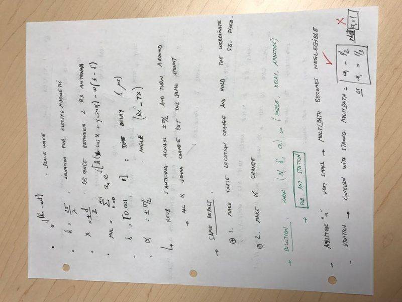

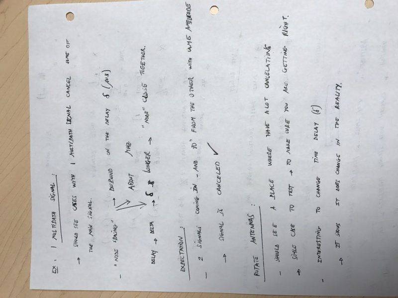

Hi jim mcnamara,
Thank you for converting the meaning of @berkeman , now I got his message. I know my codes are not right, just for the raw ideal. Therefore, I am here to ask.
And allow me to tell you my problem set up, fix me if you have chance.
GOAL: able to detect multipath.
And here is my problem set up which attached on the pdf file. Fix me if you have a chance.
Thank you.

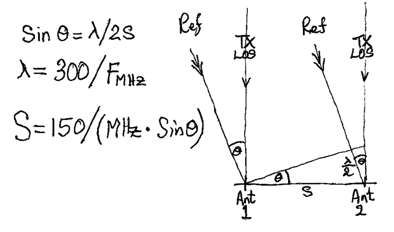

Strictly speaking, spatial diversity involves selecting one of several antennas at different times in different places to improve the reliability of reception.
To eliminate a reflection involves a phased array of antennas that are coupled to provide one signal to the receiver. The separation of the antennas in the array and the phase of coupling determines the position of the first null and so rejection of the reflection.
To receive the direct signal while rejecting the reflected signal (that has been delayed) use the following procedure.
Place two antennas Ant1 and Ant2, next to each other, separated by a distance s.
Knowing the angle of arrival of the reflection is θ from the LOS, and the centre frequency, FMHz;
Calculate; s = 150 / ( FMHz * Sin(θ) ) metres.
The direct path will be in phase and sum, while the reflection will be in anti-phase and so cancel.

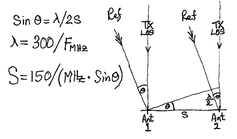

The direct path will be in phase and sum, while the reflection will be in anti-phase and so cancel.View attachment 111103
@Baluncore : Where did get those equations? Especially, The equationtion: (lamda = 300/ Fc) ? did you mean 3*10^8 speed of light?
And also, the device that I have is B200 ettus, this one have 2 antennas with distance set up by default (10 cm). it means S=10cm. Therefore, the angle theta will be too small, about 0.00016 degree.
I specify frequency is measured in MHz.
So 3x108/Fc becomes 300/FMHz
From the geometry we have equation(1); Sin(θ) = (λ/2) / s
You know that; λ = 300x106 / Fc
Therefore equation(2) is; λ = 300 / FcMHz
Substitute equation (2) into equation (1); s = 150 / ( FcMHz * Sin θ )
The “B200 ettus” does not include an option of two receive antennas with 10 cm separation. It has separate receive and transmit connectors. Either you are confusing the RX and TX antenna terminals, or the two antennas come from somewhere else. A different model, the “B210 ettus” has two receive channels, but I do not know how you can combine them in phase.
I think you must get an appropriate pair of dipole antennas for the TV frequency band and mount them on a beam with the correct separation and polarisation. You must get some form of phasing harness to combine the two antenna signals in phase into one cable, to go to one receiver antenna connector.

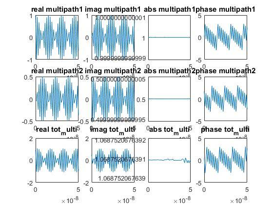

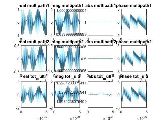

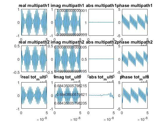

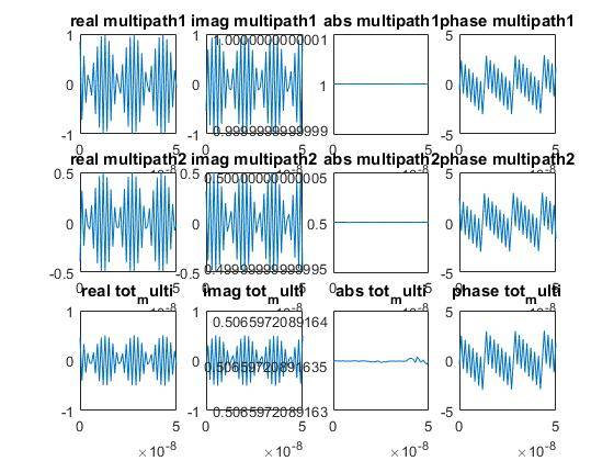

@Baluncore : Assume I have that angle, delay, and amplitude. I am using the equation above with those parameters. In the simplest case, that is 1 LOS and 1 reflected signal, I can calculate:
angle_ = [0 pi/2 pi 3*pi/2]; % same set up, same angle of the reflected signal but now rotate
t = 0:1e-9:50e-9;
alpha = [0 pi/4]; % angle betweet RXs and TX
f_c = 533e6; % center freq.
d = 0.1; % distance between 2 rx antenna 10cm
w = 2 * pi * f_c;
a = [1 0.5]; % attenuation/ amplitude
x = [-d/2 d/2]; % center of 2 RX
y = [0 0];
tau = [0 10e-9]; % time delay
general = zeros(1,length(t));
for i = 1:length(angle_)
% assume (1) for direct signal, (2) for multipath signal
multipath1 = a(1)*exp(j*(k*(x(1)*cos(alpha(1)+ angle_(i)) + y(1)*sin(alpha(1)+angle_(i))) - w*(t-tau(1)))); % for direct signal
multipath2 = a(2)*exp(j*(k*(x(2)*cos(alpha(2)+ angle_(i)) + y(2)*sin(alpha(2)+angle_(i))) - w*(t-tau(2)))); % for multipath signal
tot_multi = (multipath1 + multipath2);
end
Is this right or wrong?
Please give me suggestions. Thank you.

Because of the pdf file is too large, so I can not upload in here, therefore I broke up into single images.
For the case where the multipath delay is long compared with a carrier cycle, the max and mins of the field which are noticed as the receiver is moved are spaced nearly half a wavelength apart. So receiving antennas spaced about a quarter of a wavelength provide good diversity action, as one is in a min when the other is in a max. They are well decorrelated. This is still the case when signals are arriving by several paths, as in a typical mobile environment.
For a case where the multipath delay is small, maybe less than one carrier cycle, the max and mins of the pattern are widely spaced. This is not the case with mobile systems but occurs with microwave links, where diversity antenna spacings of a hundred wavelengths or so might be found.
The performance will also depend somewhat on how the antennas are combined. For instance, they may be added via an intelligent phase shifter, or selected by a switch, or selected after demodulation. It is not possible to just connect them in parallel because it forms an array which itself still suffers from fading as the receiver moves.
Likes Nate Duong

The information signal sending out from the Digital TV station (transmitted signal from the TX) sending information in the 2RX, assume the 2RX will receive only direct signal (LOS, no multipath)
My simple scenario:
fc = 533e6; % in Hz
c = 3e8; % m/s
lamda = c/fc; % wavelength
k = 2*pi/lamda; % notation which is used for electromagnetic
d = 0.1; % meter, distance between 2 RX antennas.
x = d/2 ; % in the center of 2 RX
delay = 0; % delay = 10e-9 in nano second, indoor the range between [10 1000] ns, because direct signal with no delay therefor it equals zero.
alpha = pi/2;
a0 = 1; % amplitude of direct signal
t = 0: 1e-10: 10e-9; % i am not sure this set up for t is right or wrong but more make sense when the delay very small in nano second.
direct_signal = a0 * exp(j*(k*cos(alpha) - w(t-delay)); % the equation can be the sum if multipath exist.
when I rotate 2 rx antennas (with same position) (just turn around) in mean angle of alpha change, so I can plot it out in very angle.
From the peak of angle0 to the peak of angle1, I can calculate the delay1
From the peak of angle0 to the peak of angle2, I can calculate the delay2
From the peak of angle0 to the peak of angle3, I can calculate the delay3
and so on ...
My questions are:
1. did I do right or wrong?
2. if i did right, what other information would I get from this case?
3. if i did wrong, what would make I wrong? and How Can I fix it?
If I can understand successfully this simplest case, I can move forward with 1 Multipath and 1 direct signal.
I hope in these details, You can understand I am trying to do and expect your suggestions.
