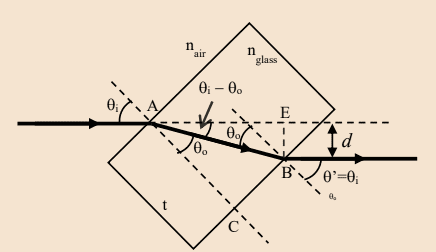

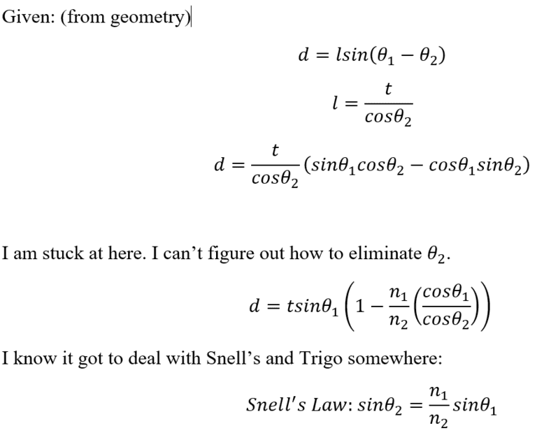

A Lateral Displacement Experiment of a laser beam pass through a rectangle glass block in environment, AIR (n1=1.00). By measuring the Incident Angle and Lateral Displacement on the Screen WITHOUT measuring Refractive Angle. Form an equation to relate the lateral displacement (d) and incident angle (θ1).

Hi @jonas_28. Welcome to Physics Forums.
Your diagram shows angles ##\theta_i## and ##\theta_0##. I guess these are what you call ##\theta_1## and ##\theta_2##. Also the diagram doesn't show distance ##l## but I guess this is what is shown as AB on the diagram. It is worth checking for consistency before posting.
Are you familiar with inverse trig' functions? If ##sin(y) = x## then ##y = sin^{-1}x##.
In your working x is ##\frac {n_1}{n_2} \sin\theta_1## and y is ##\theta_2##.
You know that ##\sin\theta_2=\dfrac{n_1}{n_2}\sin\theta_1## and you want to eliminate ##\cos\theta_2## from your expression for ##d##. Well, you also know that ##\cos^2\theta_2+\sin^2\theta_2=1.## So ##\dots##
