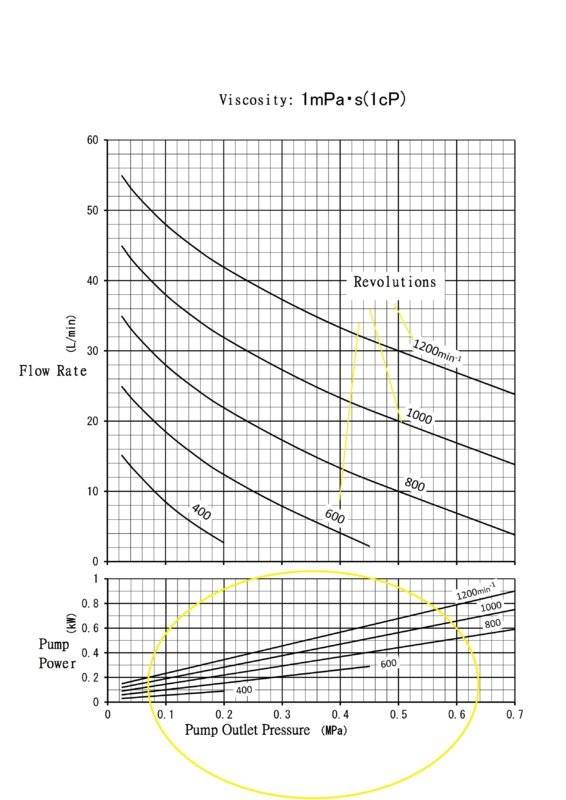

Is there any method to measure the power of the pump?
Want to know how to get the actual power the pump needs.
I can measure the flow rate by the flow meter and count the revolutions of the pump.
But selecting the proper motor for the pump would be a problem.
So I want to know how to determine the power of the rotary lobe pump and generate the graph like below.

My guess is that there is a pump but no motor. And perhaps the lower figure isn't available for that particular pump either ...
From the lower figure one could deduce a typical efficiency for that type of pump by looking at ##\Delta pV##
Which comes out pretty low -- but I'm used to centrifugal pumps. E.g: 1200/min at 6 Barg outlet pressure would be 2700 x 10-3m3/min / 60 s/min * 6 x 105N/m2 = 270 Nm/s while the lower plot shows 800 W, so around 1/3. The motor/gearbox efficiency will be over 90% , so a 1 kW motor should be adequate for that throughput. Careful calculations are in order, since the world is full of overdimensioned pump motors that waste a lot of energy money.​

Pump and motor selection starts from the system requirements, which are specified first. This can be challenging at times, but you can usually figure out the maximum flow rate by a system mass balance, and the pressure by calculating the line loss.
Step 1: Determine the required maximum flow rate and maximum pressure.
Step 2: Select a pump that delivers that flow rate at that pressure.
Step 3: Read the pump RPM from the pump curve.
Step 4: Select the motor RPM and reducer gear ratio.
Step 5: Read the motor power from the pump curve.
Step 6: Add a safety factor to the motor size. If the motor size from the pump curve is 0.5 kW, then select a 0.75 KW motor.

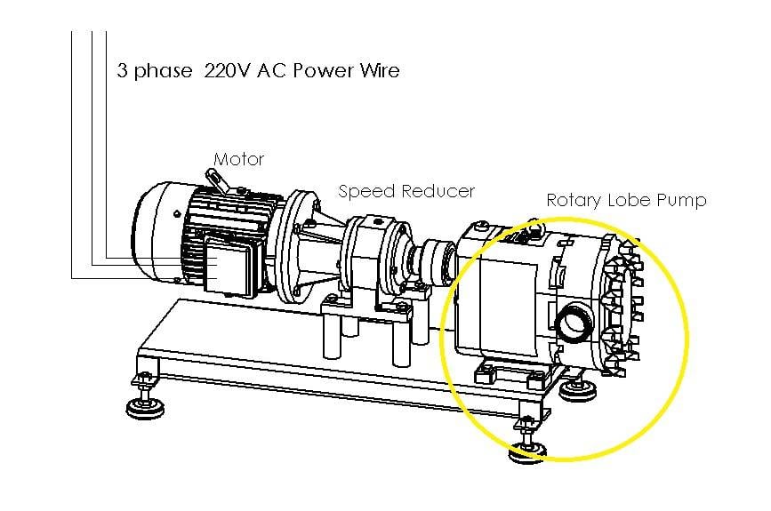

The application will decide the motor speed and power required.
What fluid will be pumped?
What is the maximum required flow rate and pressure?
What is the displacement per revolution?
What information is written on the pump, make, model, capacity?
What is the diameter of the pump input shaft? That indicates maximum torque.
