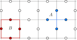

The toric code is a basic computational model as follows:
There are 2 operations that can be performed, A and B, on this grid.
To compute the value A at each point on the grid, we transform the raw values at each dot (located in between two vertices) according to some predefined operators ##f_a## and ##f_b##, and multiply the four surrounding values from the operations:
$$ A = f_a(left) f_a(up) f_a(right) f_a(down) $$
$$ B = f_b(left) f_b(up) f_b(right) f_b(down) $$

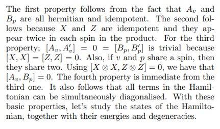

We can start by noting that Av and Bp are
Hermitian and square to the identity
What makes you think these are scalar? ##f_a(left)## is an operator, and you multiply four of them together to get another operator. I think each of these operators is an operator on a large dimensional space, which (for the Z's and X's in the paper, ##f_a(x)## and ##f_b(y)## in your notation) is the identity everywhere except is a Pauli matrix on some specific subspace.

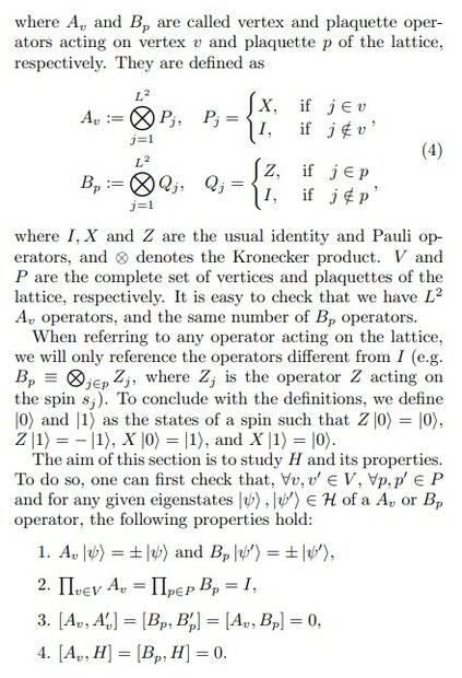

No, for two reasons. 1.) Why are you applying the operator to a state? An operator can just exist, and they can be multiplied and added. 2.) It says the spin state of each node is being tracked separately. So your state vector is actually going to be very large, not a vector of length 2.

No. Each ##f_a(x)## is already an operator defined on the large state of all spins. At that point you just do normal matrix multiplication.
The matrix representation of each ##f_a## is conceptually similar to what you described for a single 2x2 block, except kronecker products are more complicated (recall the dimension of the spaces grows multiplicatively as you add more products, not linearly) so it's better to just keep everything in tensor product form the whole time and not try to write down a matrix.

No, the matrix will be ##2^{10,000}## by ##2^{10,000}## which is why they are not writing things down as matrices and you shouldn't either.
Remember how kronecker products work. Suppose I have three spin states, and each one has a 2 dimensional basis ##e_0## and ##e_1##. Then the product has a basis of dimension 8, i.e ##2^3##

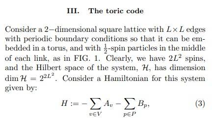

Hi, something seems off with this discussion, perhaps not. If I may, the paper models a system of spin-##\frac{1}{2}## particles interacting along the spin ##z##-direction only. Each spin is associated with an edge. The system state space is the tensor product of all the spins 2D spaces. If there are ##N## spins then the operators, ##A_v## and ##B_p##, are ##2N\times 2N## matricies. In fact the ##A_v## and ##B_p## are all diagonal since only ##\sigma_z## for each spin is used.

Let's calculate A at a point ##A_{100}##, with its neighbors being left= ##[1,0]##, up=##[0,1]##, right=##[1,0]##, down=##[0,1]##.
The X operator for A is the matrix
$$X = \begin{bmatrix}
0 & 1 \\
1 & 0
\end{bmatrix}$$.
How should we compute the plaquette operation ##A_{100} = \sigma_{left} \sigma_{up} \sigma_{right}\sigma_{down}## from here?
How should we compute the sum ##\sum_{grid} A_n## over all grid points, and what on earth is being Kroneckered ##\otimes##?
The paper says the Hilbert space has dimensions ##2^{2L^2}## which I think agrees with my interpretation and not yours.
Yeah, I think I agree here. A 2 spin system has 4 states and a three spin system 8, not 6 Like what I just posted again.
Okay, Office_Shredder gave the proper way to form the state space for a three spin system in #10.
Let ##Z_k## be the operator for the z-component of spin index ##k##. This operator acts only on the k-th spin independent of all other spins. These spins are fermions so all spin components of spin k anti commute with every other spin, $$Z_kZ_j=-Z_jZ_k$$ whenever ##k\ne j##. All ##A_v## commutes with every other ##A_v## because they are even products of anti commuting operators. The ##B_p## operators are constructed using the ##X_k## components. ##Z_k## definitely does not commute with ##X_k## so checking that ##A_v## commutes with all the ##B_p## needs to be shown.
The matrices associated with these operators are immense but the algebra they obey is straightforward.

I really want to emphasize this. For a 100 by 100 grid you have an algebra of about 20,000 matrices where you can write down exactly how each product of matrices works in a couple sentences. If you want to represent them as matrices by their definition you need like, more numbers than there are atoms in the universe. So you definitely should not do that.
