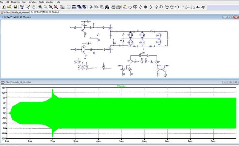

How I can boost the output voltage to the desired level i.e. 15~18Vpp.
Hello everyone, I’ve been working on modifying the RF Power Amplifier circuit, and I’ve made good progress (schematic is attached below). However, I’m now facing a small issue – I’m currently getting an output voltage of around 9Vpp, but I need it to be in the range of 15–18Vpp. I’ve tried changing the values of resistors R6, R7, and R8, but I haven’t been able to reach the desired voltage level. I would really appreciate any advice on how I can boost the output voltage to the desired level. Thanks in advance for your help.

Welcome to PF.
What is the application of this PA?
What simulator are you using? LTspice?
Attach your .asc file as a .txt file to your next post.
1. Increase Vdd.
2. Raise the output impedance of the band-pass filters.
