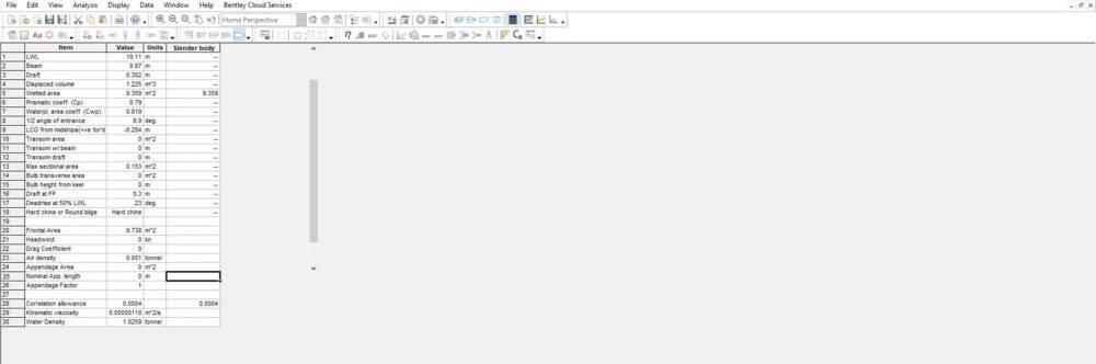

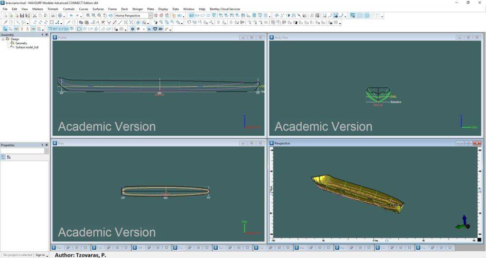

Hi there,
I have modeled with MAXSURF a few variations of a prehistoric logboat in order to test a few theories. Now, I am trying to look at resistance-performance over a range of speed. To do so, I need to include a constant drag coefficient without knowing the drag force and velocity (both will be estimated after the resistance analysis).
So, CD = (2*FD)/(ρ*v2*A) is not an option since I am missing FD and V. Also, I cannot solve Cd in terms of the Reynolds number since Re and Cd can relate through velocity.
Is there any other workaround? For now, I just need a constant drag, then I will just use speed^2 and projected area.
Thanks in advance

That's an interesting approach thanks! Well, I actually have the surface model in a digital form though. So, do you believe that the use of an approximate Cd would not allow me to later infer the actual one?
Thanks for your help guys. I'll try to test a few of the things proposed and integrate them into MAXSURF resistance software. I'll keep you posted for the results.
