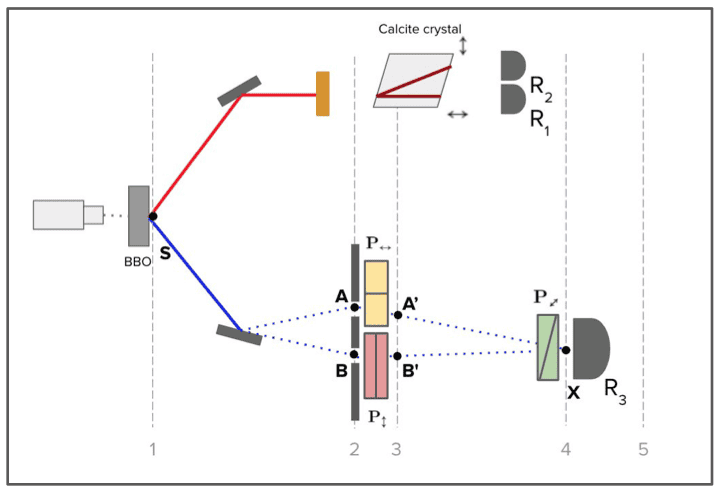

Perhaps if I share an image representing the proposed experiment it will help focus my question:
The source sends single photons at a time. The BBO crystal creates an entangled pair of photons where one is polarized either vertical or horizontal, and the other is the opposite. The signal photon travels the blue line towards the double slit which has orthogonal polarizers, and there is a diagonal polarizer before the back screen R3. The idler photon travels the red line and just ends up at an absorber.
QUESTION #1: According to Standard Quantum Theory we should get a particle pattern at R3, right?
QUESTION #2: But according to Von Neumann-Wigner, since no which-path information is ever made available to any conscious observers, we should get an interference pattern at R3. This is because there are no optics issues preventing the interference pattern from showing in the case were there is no collapse, right?

Where are you getting your information on the "Von Neumann-Wigner Interpretation"?
ChadGPT said:
Standard Quantum Theory predicts the opposite (it not necessary for any conscious observer to actually be able to measure the polarization states, it is enough that they are determined by the presence of the polarizers).
This is not correct.
A correct statement is that in the double slit experiment, with the orthogonal polarizers present, there will be no interference pattern at the detector, whereas without the polarizers, there will. This both a prediction of "Standard Quantum Theory" (by which I assume you mean the basic math of QM without adopting any particular interpretation) and an experimentally confirmed fact. However, this is true independent of any interpretation, and says nothing about "collapse" at all.

We already know the experimental answer to this question: just the presence of orthogonal polarizers is sufficient to destroy the interference pattern. There is no need to measure the polarization states.
What exactly is an open question here?
We do, but not for the reason you think.
First consider the signal arm of your experiment with an ordinary, non-entangled photon as input (i.e., no BBO crystal and no idler photon). Then the diagonal polarizer cancels out the effects of the orthogonal polarizers at the slits, and you get an interference pattern.
However, the fact that in your setup, the photon in the signal arm is entangled with the photon in the idler arm, destroys the interference pattern, regardless of whether there are any polarizers in the double slit setup. If that were not the case, if interference could be produced at all in the signal arm, then it would be possible to set up a scenario to transmit information faster than light, by changing what was done in the idler arm, for example by choosing to measure the idler photon polarization at a different angle, and thereby instantaneously changing whether or not interference was present in the signal arm. This would violate the quantum no signaling theorem. (For a similar scenario, see Exercise 9.6 of Ballentine.)

Again, where are you getting your information on the "Von Neumann-Wigner" interpretation?
The response I gave above is interpretation independent; it's a prediction of the basic math of QM. So any valid interpretation of QM should agree with it.
It is a quirk of entangled photons that they do NOT produce interference patterns in a setup as you present here. At least not like you imagine. Reference below.
Imagine we have NO polarizers at all in the R3 path. The entangled photons do NOT produce an interference pattern, exactly opposite of your expectation. Since there is no interference in the first place, there is nothing the removed polarizers can do to create it. Now why is that? It turns out that entangled photons lack the coherence necessary to drive the double slit setup in a superposition and produce the usual interference.
You can modify the setup to place a single slit in front of (to the left of) the bottom double slit screen. But if you do, it destroys the entanglement with the photon at the top. Which in turn renders anything you find out from R1/R2 superfluous.
See Experiment and the foundations of quantum physics (1999) by one of the 2022 Nobel winners. See Fig. 2 and related text: "Will we now observe an interference pattern for particle 1 behind its double slit? The answer has again to be negative because by simply placing detectors in the beams b and b' of particle 2 we can determine which path particle 1 took. Formally speaking, the states ... cannot be coherently superposed because they are entangled with the two orthogonal states..."
