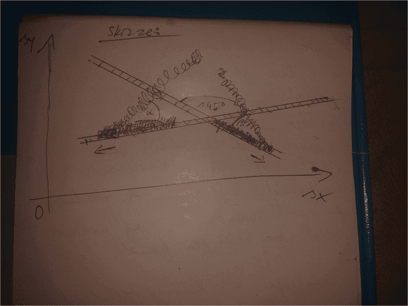

So here is my question: I asked you about a solution approach/solution for the following task: Two rail paths cross at an angle of 145 °. With a constant speed of 60 km/h, they just drive along their tracks, and each of them repels steam/smoke flags, which, among other things, are deflected by a wind that does not change its direction and keeps its speed. Be. Order is the determination of the direction or vector coordinates and the velocity of the wind.
See (sketch): https://share-your-photo.com/12ca4a26fe
depending to the sketch:
α=36°
β=18°
[/B]
My ideas: I know that all vectors are komplanar to each other because they are all on one level (r ^ 2). Accordingly, each vector can also be represented as a linear combination of the other.
So my idea in this direction went to determine the searched vector by means of this method, but the coefficients are unknown. How to solve it by construction is unclear to me (the picture of me is supposed to be accepted as scale). The speed could sometimes be determined by the Fahrrwind = Speed trains. I have no detailed idea of a solution regarding this problem, which is why I ask for help.

Thank you so far, I'm not quite sure what it would look like when I print for tan beta. Above that one has two partial speeds, almost one of these simply over the Pythagorean theorem to a set together?
*the different velocities
Excuse me for the picture. Train number 1 isn't moving parallely to x-axis. So is it right that s_1_y should be 0?
The triangles in the sketch by the Rachfahnen are not perpendicular, you can not use angular functions like tan?

If it is not moving parallel to the x axis, then we are back to the situation where we do not know which direction either train is moving in the (x,y)-plane, therefore we can not define the direction of the wind. Unless you were given some direction information which for some reason you omitted.

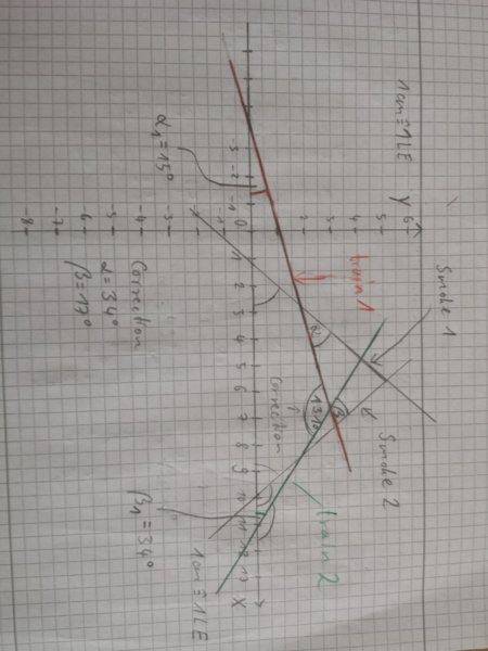

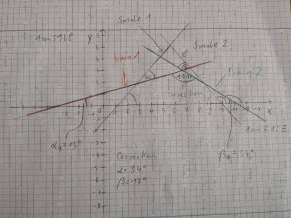

Sorry, I have informed myself again about the task and so the angles are corrected. The differences are not very much, the relations are still the same. Also the directions of both trains are given with angles and there is a x and y axis. Excuse me for some cases I just used in some cases google translator. :D
