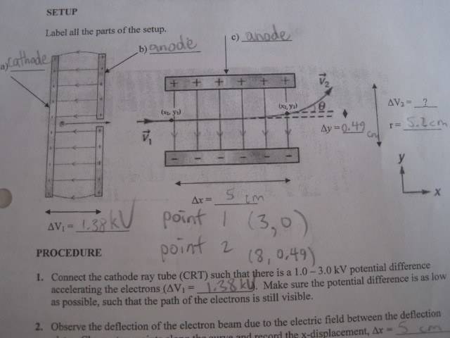

i don't have the velocity so i don't know how. If i did have velocity i would find time.
I am on thin ice here, but its ok I am happy making a fool out of myself
Don't you use the potential between the cathode and the anode and the charge on the electron to calculate the energy gained in traversing the first part of your diagram and equate this to the kinetic energy to solve for the velocity as you leave the slit in the vertical anode
1/2 mv^2=eV
Ty what do I do after?
i have the initial velocity what do i solve for next? ε, acceleration, Fe, final velocity? how to find potential difference
never mind i got it.
