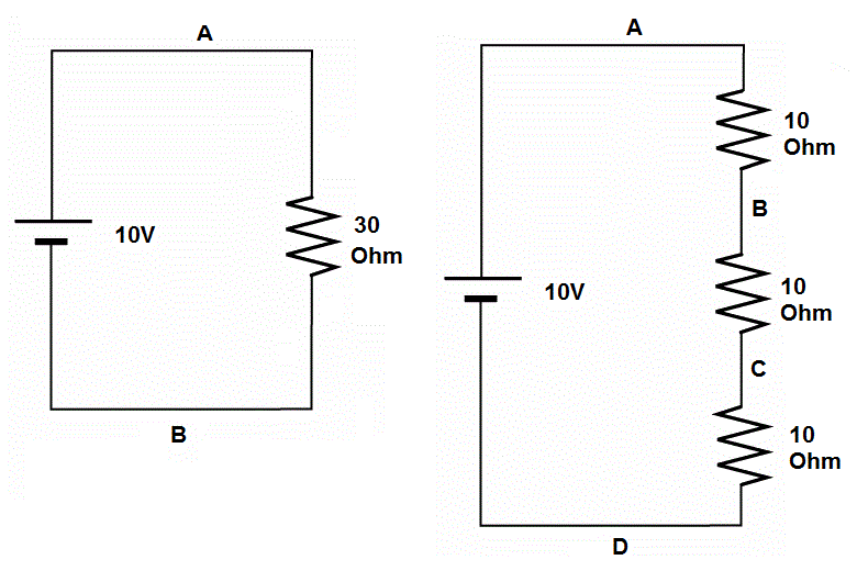

a little pic I put together for you to ponder on ...
The measured current at any of those points in either circuit will be the same 0.33 ADave

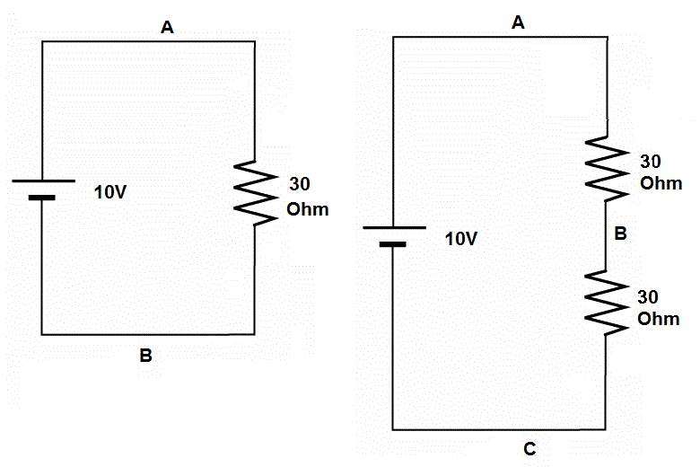

now to take it a step further
a single 30 Ohm resistor we know that the current in the circuit is 0.33 A
I = V/R
I = 10 / 30
I = 0.33 A
we ADD a second 30 Ohm resistor
I = V/R
I = 10 / 60
I = 0.166 A
so you can see, adding a resistor does decrease the current
in the first circuit, the measured current at A or B will be the same = 0.33 A
in the second circuit, the measured current at A, B or C will be the same = 0.166 ADave
