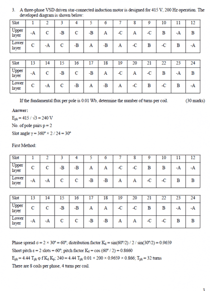

i do not know why pole pair =2 and it is short 2 pitch.
how can i find pole pair and short pitch from its original developed diagram?
i know that Phase spread=60(we choose)
So for narrow spread ,the pattern is A-CB-AC-B
for m=2 for each phase it have 2 slot.
