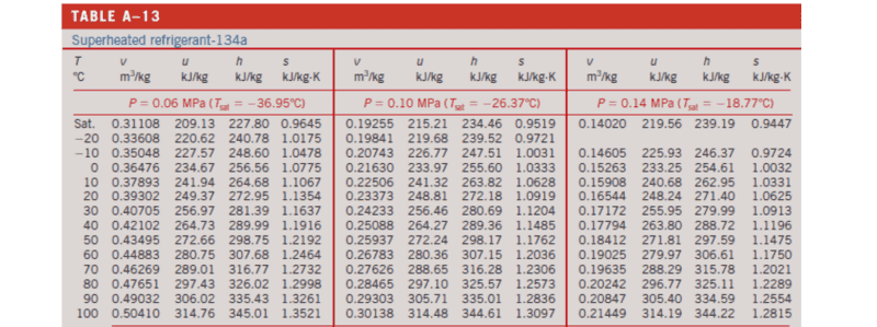

I don't understand how the solution got its values, not from the tables right? because I couldn't find such value from all of the tables. Since the pressure is less than the saturated pressure at given temperature, it is in super heated phase. but 90.4 kpa equals 13.1 psia, which is not in the super heated table. can we calculate specific volume without the tables? can we find its volume by finding the density at given temperature and pressure since the mass is known? but which would also require a table to find such density...

Your book (Moran et al) also has a table in metric units, doesn't it?

Thank you, I found the SI system tables, but i still don't see 0.2302, it is in this region correct? View attachment 216340
where P= 0.10 MPa
Yes. You have to interpolate in the table. Since the behavior is close to ideal gas behavior (with Pv nearly constant), for good accuracy, you should interpolate on (Pv) rather than simply on v.

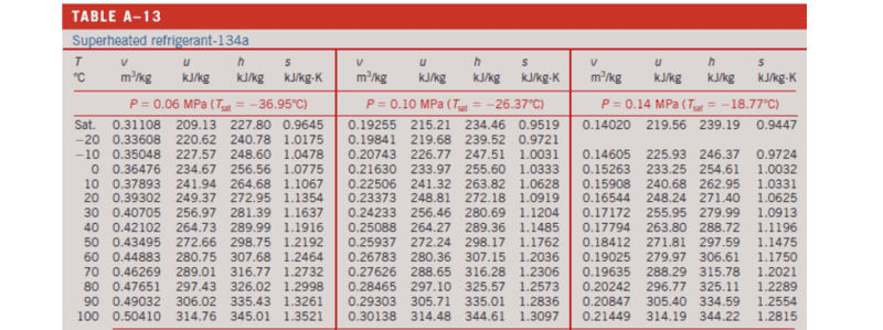

Thank you, now I understand what you said about Pv being nearly constant. I just want to confirm, you said interpolate on Pv, you mean like this?:
I got v= 0.2326, a little off from 0.2302.
At P= 60000 Pa, v = 0.35048 m^3/kg, and Pv = 21029 J/kg
At P = 100000 Pa, v = 0.20743 m^3/kg, and Pv = 20743 J/kg
So, at P = 90400 Pa, $$Pv=21029+\frac{(90400-60000)}{(100000-60000}(20743-21029)=20812$$ And, ##v=20812/90400=0.2302## m^3/kg.

Thanks a lot! I am so careless, I made a mistake by using P2= 0.14 Mpa instead of 0.1 Mpa.
