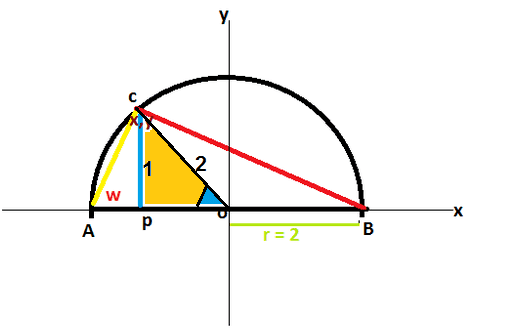

d(y)/d(x) --> max area
area of triangle = 1/2 . base . height
for number (2) [/B]
x^2 + y^2 = r^2 --> circle equation
base = 2R, height = y
Area = 1/2 . 2R . y
area = 1/2 . 4. √ (r^2 - x^2)
area now is half of max = 2, so :
2 = 1/2 . 4. √ (r^2 - x^2)
2 = 2 √(4-x^2)
1 = √ (4-x^2)
1 = 4 - x^2
x = √3
now y = 1
AP = 2 - √3

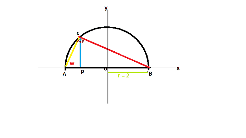

I have to find w (angle of ACB)
PC = 1
how to find w ?
Consider the triangle AOC.
OC^2 = AC^2 + AO^2 -2AC.AO.cosw
4 = 4 + (8-4v3)^2 -8(8-4v3)cosw
Cos w = (8-4v3)/8
Cos w = 1-1/2v3
But the answer is in degrees, and not allowed using calculator.. And I don't think my answer is right.
Note: v3 = root 3
Consider the triangle AOC. You can find the angle at O by studying the right triangle CPO.
I don't get it.. Can anyone help??
CPO is a right triangle. You know the hypotenuse, it is one radius, length 2. You calculated PC, it is 1. What is the blue angle then?
Likes Helly123
The blue angle is 60degrees.
No. Imagine half of an equilateral triangle, rotated :smile:
Oh.. 30degrees ...
So, i get it. One triangle = 180degrees. I get 30, left 150. CAO = ACO. So CAO = 75 degrees?
But with theory, it should be sin w/ 2 = sin tetha / AC
I get sin w = 1/AC
While AC = 8-4root3
How can i get w with this method?
Yes, it is correct.
