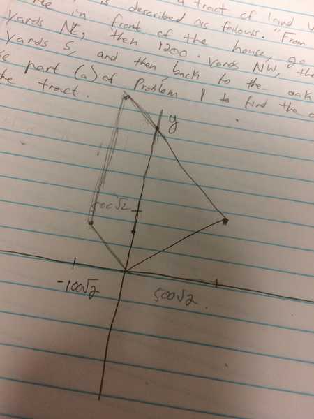

You have inherited a tract of land whose boundary is described as follows. ”From the oak tree in front of the house, go 1000 yards NE, then 1200 yards NW, then 800 yards S, and then back to the oak tree.
Line integral of Pdx + Qdy = Double integral of partialQ/partialx - partialP/partialy
I'm very confused as how to approach this function, given that I don't have any equations to work with. Do I start by having the first thousand yards extend from the origin, and then find the coordinates of the lines? I don't really know.

I'm having trouble constructing the integral given that I have four different lines on my cartesian plane. Usually I just have to deal with 2 separate functions, but here it looks like there are four.
A triangle should only involve three lines (three angles and three sides). Please look again.
So, the calculation will require twice as much work as you have done before, but the principles are no different from what you have done already.

This is the image I got, I'm not sure how to proceed from here though.
What are the ##P## and ##Q## that you want to use? What is preventing you from integrating ##P dx + Q dy## over each of the four line segments? You MUST TRY: we cannot do your work for you.
