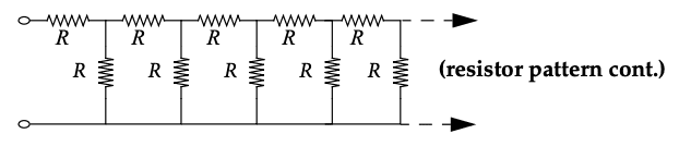

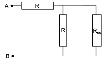

We are asked to find the equivalent resistance of the network
as viewed from its ports.

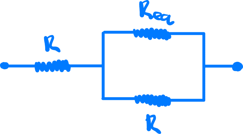

I simplified the network as
Where ##R_{eq}## is not only the equivalent resistance of the branch shown above, it is also the equivalent resistance of the entire network shown above (because the network shown above repeats itself infinitely).
Then
$$R_{eq}=R+\frac{R_{eq}R}{R+R_{eq}}$$
$$R_{eq}(R+R_{eq})=R(R+R_{eq})+RR_{eq}$$
$$R_{eq}^2=R^2+RR_{eq}$$
$$R_{eq}^2-RR_{eq}-R^2=0$$
$$\Delta = R^2+4R^2=5R^2$$
$$R_{eq}=\frac{R\pm R\sqrt{5}}{2}$$
$$=R\frac{1\pm\sqrt{5}}{2}$$
Is this result correct?
Here is the problem set in full if it is useful.

Seems like a clear approach. If your algebra is correct I'd say you have it correct.
##R=\frac{1-\sqrt{5}}{2}## certainly isn't correct.
Have you checked your own work? How would you use that (positive) value to check?
Your approach is fine. I think the circuit you want is the one shown below in which the resistance between points A and B is to be found is clearer about what you are replacing with what in view of the drawing provided by the problem.

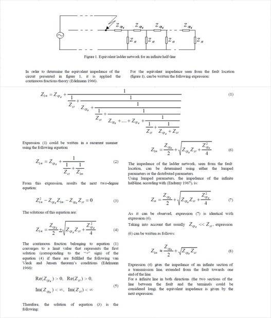

Babadag said:
According to (Endreny 1967)
Endrenyi, J., “Analysis of transmission tower potentials during ground faults" for a transmission line R1∞=R/2+sqrt(R^2+R^2/4)
If not already clear, note that "R/2+sqrt(R^2+R^2/4)" simplifies to ##R \frac {1+\sqrt 5}2##.
Likes Babadag
The second addend in the expression ## R _ { eq } = R \frac { 1 } { 2 } + ( \pm R \frac { \sqrt 5 } { 2 } ) ## is resistance and must be positive. This is why ## R _ { eq } = R \frac { 1 + \sqrt 5 } { 2 } ## is the only acceptable solution.

It is indeed but the answer can't be in negative so + one is right
