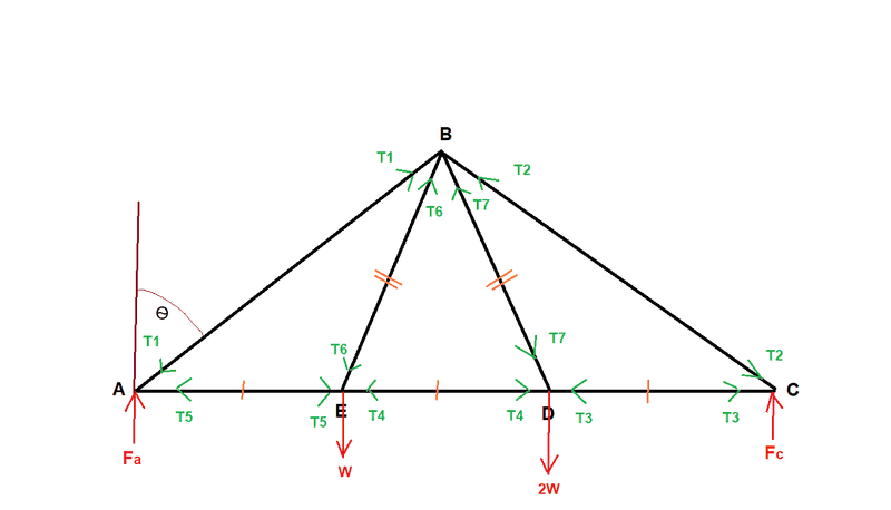

Could I please ask for help in how to do this question.
Is it in fact well formed, can it be solved as it is or do I need more information?
Q. Find the external forces and the force in each rod in the following framework of light rods which is supported and A and C:
So, I need to find Fa, Fb and T1, T2, T3, T4, T5, T6 and T7 in terms of W.
I mark all forces as pointing towards the ends of the rods so that in the answers a negative value indicates a force towards the centre of a rod.
I call the length of the sides marked with a single bar "L".
I have labelled the angle Ѳ on the diagram for use in the following.
Taking the framework as a whole and resolving vertically gives:
Fa + Fc = 3W
Taking moments about A gives:
Fc * 3L = W * L + 2W * 2L and so this gives Fc = 5W/3 and so we also now know that Fa = 4W/3. These answers agree with the book answers.
Now, looking at the forces incident at A and resolving vertically we have:
T1 * cos(Ѳ) = 4W/3
and resolving horizontally we have that
T1 * sin(Ѳ) + T5 = 0.
From this, using cos^Ѳ + sin^Ѳ = 1 we can obtain:
16W^2 + 9*T5^2 = 9 * T1^2.
Now this agrees with the book answers for T5 and T1 (which are given individually), but I cannot see how to get them individually.
(In previous questions of this type I had always been provided with the angle of the figure - in this case, if I knew Ѳ then I could obtain T1 and T5 individually).
If I take the book answers for T1 and T5 and use my equations above I get that the principal value of Ѳ = 60 degrees. Does that need to be marked in the diagram for the question to be possible? Or should I be able to see how to derive the angle from the given geometry?

Sorry, I don't completely understand your question.
That angle is very important, because the higher the location of node B is, the lower the value of each internal tension should be.
That's very helpful to hear. You see, in the book the diagram is presented without any angle being given. I was thinking that I must be missing something. I don't think that it is solvable without the angle being given. In this case Ѳ = 60⁰.
Is it possible that somehow they give proportions of the formed triangles, or lengths of the bars, or A-B-C-D-C distances?
No, nothing else is given. I'll assume that 60⁰ was meant to be given and go from there.

I am a little bit surprised to see it says
[tex]T_1 \neq T_2, T_6 \neq T_7, T_3 \neq T_5[/tex]
after looking at your sketch which shows axis symmetry wrt vertical line passing B that would suggest
[tex]T_1 = T_2, T_6 = T_7, T_3 = T_5[/tex]
Something seems to be wrong with the answer or the sketch at least.

Please, note that loads W and 2W are located in symmetry with respect to the vertical line passing B, but the summation or total force is off-center.

Then your observation was incorrect. Loads W and 2W are positioned symmetrically, but they are obviously not of equal weight and so their weights are not distributed symmetrically.
If the book answer is right the settings of the problem seem to be
[tex]\angle BAE=\frac{\pi}{6}, \angle BED = \frac{\pi}{3}[/tex]

Can I chip in...
Let α = ∠BED = ∠BDE
Resolving vertically at point D gives ##|T_7| sinα = 2W##.
Resolving vertically at point E gives ##|T_6| sinα = W##.
This means ##T_7## should have twice the magnitude of ##T_6##. But the ‘official’ answers (as given in Post #6) say the opposite.
It looks like the official answers for ##T_6## and ##T_7## are the wrong way round. If that’s the case, I think that's consistent with ##α = \frac {\pi}{3}##.

Thanks for nice observation. For investigation in #10 I made the symmetric case in both load position and load quantity, that is
[tex]t_1=t_2=T_1+T_2[/tex]
[tex]t_3=t_5=T_3+T_5[/tex]
[tex]t_6=t_7=T_6+T_7[/tex]
[tex]t_4=2T_4[/tex]
where new t's are tensions where loads 3W are put on E and D. This process happened to hide that wrong way round.
