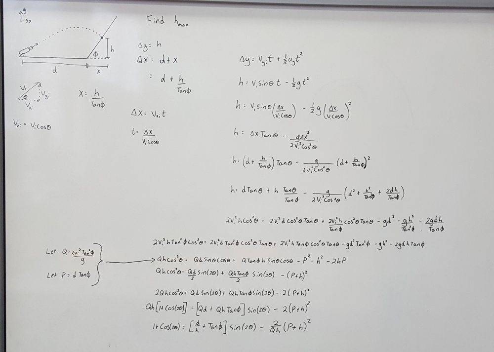

You see an enemy archer and decide to position yourself on the side of a hill with a 60 degree grade. The enemy archer is 300 meters from the base of the hill. If the enemy's bow fires arrows at 60 m/s, how high (measured vertically) do you need to be on the hill to be out of range of the enemy archer?
Kinematics: ##x(t)=x_i+v_it+\frac 1 2 at^2##
Here's a fully typed version of the problem with a diagramMy attempt:
Given the angle of the hill, I know that the horizontal displacement of the arrow and my vertical height on the hill are related by
##Δx=d+\frac h {Tan(60)}## ...(1)​
where d is the distance of the enemy from the base of the hill (300 m). I also know that there is no acceleration in the horizontal direction, and the time of flight of the arrow is the same for the horizontal and vertical directions, leading to the following:
##Δx=v_{xi}t~~## ⇒ ##~~t=\frac {Δx} {v_xi}##​
##Δy=v_{yi}t-\frac 1 2 gt^2~~## ⇒ ##~~Δy=v_{yi}\left( \frac {Δx} {v_xi} \right) - \frac 1 2 g \left( \frac {Δx} {v_{xi}} \right)^2## ...(2)​
If I now substitute eqn (1) into (2), and let ##Δy=h##, I get:
##h=v_{yi} \left( \frac {d+ \frac h {Tan(60)}} {v_{xi}}\right)-\frac 1 2 g\left( \frac {d+ \frac h {Tan(60)}} {v_{xi}}\right)^2##​
Lastly, I know that the components of my initial velocity are related to the launch angle by:
##v_{yi}=v_isinθ##​
##v_{xi}=v_icosθ##​
Now, to find the maximum height, I need to maximize "h" as a function of theta by taking dh/dθ=0. The problem is that I'm having trouble getting "h" as a function of "θ". I'm getting stuck in the algebra somewhere. Anybody have a handy way to simplify this a little further? (I drew it as a cannon on the whiteboard, but same idea)
241646
I feel like there must be a trig substitution or something that I could have employed much earlier in this process to make my life easier.

When ##h## reaches its maximum, does ##\Delta x## also attain its maximum? If so, what does that tell you about ##\frac {dh}{d\theta}## and ##\frac {d (\Delta x)}{d \theta}## when these derivatives are evaluated at the value of ##\theta## that corresponds to maximum ##h##?
Yes I suppose it does. That would mean that ##\frac {dh} {dθ} = \frac {d(Δx)} {dθ} =0##.
I've gone ahead and given that a try, but the displacement I get is dependent on that optimum launch angle, and I still don't know that. I'm fairly certain that I've done the derivatives correctly, but maybe I'm missing something?
241659

I agree with your result for the relation between ##\Delta x## and ##\tan \theta##.
You can use it to replace ##\tan \theta## in terms of ##\Delta x## in the first equation in the picture of your last post. Note ##\frac{1}{\cos ^2 \theta} = 1+ \tan ^2 \theta##.

Unfortunately, plugging that in makes it blow up into a crazy 4 order polynomial that I have no clue how to solve. I'm probably going to just use a numerical solver rather than trying for the analytical solution. I really would have expected it to be a nicer outcome than this.
Thank you so much for the help though!
You should find quite a bit of simplification after substituting for ##\tan \theta##. You should get a quadratic equation for ##\Delta x## (or for ##h##, if you prefer).
