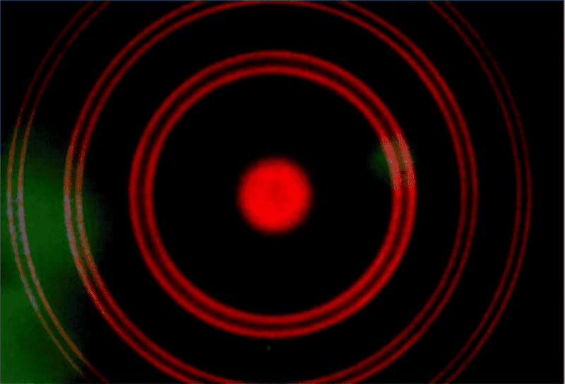

Solve for ##\frac{\delta}{\Delta}## for the respective "orders" and "rings". Definitions would be shortly explained below.
##\delta## = net change in area between two neighboring rings.
##\Delta## = net change in area between two neighboring orders.
For the image below, each order has 2 rings (with an "invisible" central ring as well). Thus, there are 3 orders and 6 rings for the below image (the center smudged circle does not count).
To find ##\delta## for the 1st order, all I need to do is to square the diameter of the 2nd ring and subtract it to the square of the diameter of the first ring.

Please supply some additional info. : Is this from a Michelson or Fabry-Perot interferometer? I'm puzzled by the size of the central spot=perhaps there is a reason why it has a finite diameter, but I haven't figured that out yet. Edit: It looks like some kind of crystal scattering experiment, perhaps a powder, where the source contains two closely spaced (Zeeman split) spectral lines.
In addition was the path difference ## 2d ## for the center rays set to zero, or is it some finite but unknown number?
Presumably it is a Zeeman splitting of a single line. What is the element that was used in the experiment?
Thank you, @Charles Link, for your response. Below are my answers to your questions. Hopefully, it helps.
This is from the Fabry-Perot interferometer.
Before the current to the coil of the magnet was provided (i.e. I = 0), the rings did not split and the central "spot" did not "exist" or was not visible either. However, as the current increased, the splitting began to occur for the rings for this longitudinal (unpolarized) Zeeman effect. Of course, the central spot became gradually visible too. To view the splitting effect as the current increases, refer to this Google drive link here to preview the images.
Usually, there ought to be three lines per order. After rotating the optical axis (I believe), I got (as shown in the image) the longitudinal Zeeman effect (which contains 2 rings per order).
Charles Link said:
In addition was the path difference 2d for the center rays set to zero, or is it some finite but unknown number?
To find the areal ratio (##\delta/\Delta##), I did not bother to find the diameter of the central "spot" as it just keeps getting larger when the current increases. As I am not entirely sure what you mean by the "path difference 2d from the center rays set to zero", I am also not certain did I properly answer your question here either.
The above image is for a red cadmium line where ##\lambda \approx 644## nm.
If you need more information, please do let me know. Thank you!

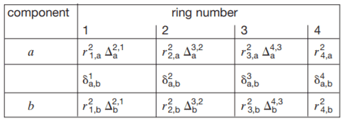

Thank you for the response, @Charles Link. Ironically, I have read the same article you sent here. A good article that relatively encompasses the scope of my question can be found here too: https://www.nikhef.nl/~h73/kn1c/praktikum/phywe/LEP/Experim/5_1_10.pdf.
To put it shortly, I am supposed to find a ##\delta/\Delta## vs. ##B## graph. While I am able to find the magnetic field for a given current, I am trying to figure out how many areal ratios I ought to have for the figure.
For example, in a PDF provided by PHYWE (which I will attach here as it is made available for free online), they found the following ring diameters and then got corresponding (##\delta/\Delta##) as shown below:

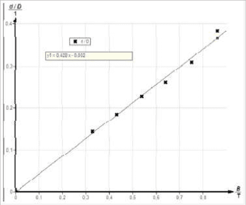

Graph for the above:
What I find odd is how does the paper find numerous ##B##'s for 1 image on the Zeeman effect. In addition, how does the author find 6 ##\delta/\Delta## values for the 6 corresponding rings?

They did the experiment 6 separate times, each with a different coil current on the electromagnet to have 6 separate magnetic field ##B ## values.
I still haven't figured out how to analyze the center spot, but it gets a number between two integers ##n_o ##, and then the first maximum has order ##n_1 ## as the first integer less than that.
You will get an average ## \delta ## and ## \Delta ## for each ## B ##. These you use to make the line graph of ## \delta / \Delta ## vs. ## B ##.
I think the analysis of the central spot in detail, (perhaps more than you need), for the Fabry-Perot etalon is semi-complicated because of the multiple reflections. For a Michelson interferometer the intensity pattern is more readily computed. Here I think all you need is to figure out the maxima starting with ## n_1 ##.
I believe there is a typo on the bottom of page 5 on the left side of the page: It should read ##\delta_{a,b}^p=r_{p,a}^2-r_{p,b}^2 ##.
The ## \delta ## and ## \Delta ## are readily computed for a set of rings for a given ## B ##.

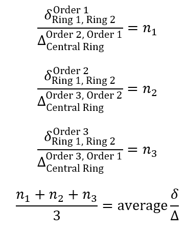

Allow me to first assume an arbitrary value for B (e.g. B = 800 mT). Thus, to attain the average ##\delta## and ##\Delta## for each ##B##, I need to first find the individual components to the "delta ratios" before calculating the average number. Below is my approach.
*Note that the equational definitions for ##\delta## and ##\Delta## are defined in the relevant equation section.
Does the above thought process look fine? Particularly, I am concern about the last ##\delta/\Delta## I wrote down as finding the net change in area between orders 3 and 1 just seems really off. Usually, it ought to be finding the net change in area between orders 4 and 3. However, as order 4 does not exist, this is proving to be a bit problematic.
Note that the above equation applies to the below image.
How is my thought process coming together? Are there any errors?
Thank you for your help!
For the last ## \Delta ##, use the average of the previous two ## \Delta ##'s. (The ## \Delta## 's for a given ## B ## should all be nearly the same). Otherwise, it looks very good.
Likes Athenian

On second thought, as mentioned once, I was creating a ##\delta/\Delta## versus ##B## graph. In other words, for slope, I get:
$$m = \frac{y}{x} = \frac{\delta}{\Delta B}$$
Therefore, to find the value of ##\mu_B## from a graph of a normal Zeeman effect, I can get the below equation.
$$\mu_B = \frac{hc}{2\mu t B} \bigg(\frac{\delta}{\Delta}\bigg) = \frac{hc}{2\mu t } \cdot m$$
The above is the "graphical" approach to finding ##\mu_B## that I just figured out.
Of course, for the anomalous Zeeman effect, I get the below equation to find to ##\mu_B##.
$$\mu_B = \frac{hc}{4\mu t B} \bigg(\frac{\delta}{\Delta}\bigg) = \frac{hc}{4\mu t } \cdot m$$
Likes Charles Link
Very good. It looks correct. The anomalous case and the exact factor to use in the denominator looks a little complicated=I will need to study that paper further, but I think you might have it right. Very good so far. Keep up the good work. :)
Try plugging in a couple of values if you have them, and see what you get for ## \mu_B ##. It helps to have the slope of the graph to get the average, but a single value of ## \frac{ \delta}{\Delta } ## and ## B ## will suffice.
Note: In this case, the graph passes through the origin, so the slope is simply the best straight line fit through the points including the origin=in principle the slope is simply getting an average value of ## \frac{\delta}{\Delta}/B ##.
Likes Athenian

Meanwhile, for a couple of simple derivations:
For the same wavelength at adjacent maxima ,## m \lambda=2nd \cos{\theta_m} ##, and ## (m-1) \lambda=2nd \cos{\theta_{m-1}} ## gives by subtracting that ## \lambda=2nd (\cos{\theta_m}-\cos{\theta_{m-1}}) \approx 2nd ((1-\theta_m^2/2)-(1-\theta_{m-1}^2/2)) \rightarrow \Delta (\theta^2 )=\frac{\lambda}{nd} ##. Seeing that ## \theta ## is proportional to ## r ##, (and ## \theta^2 ## is proportional to ## r^2 ##), this gives the parameter which they call ## \Delta=C \, \Delta (\theta)^2=C (\frac{\lambda}{nd}) ## .
For two closely spaced wavelengths at the same maximum, ## m \lambda_a=2nd \cos{\theta_{ma}} ##
and ## m \lambda_b=2nd \cos{\theta_{mb}} ##, so that ##m \Delta \lambda=2nd (\cos{\theta_{ma}}-\cos{\theta_{mb}})=nd \Delta (\theta')^2 ## where the small angle approximation is used again on the cosines. This gives ## \Delta (\theta')^2=m \frac{\Delta \lambda}{nd} ##. With ## m \approx \frac{2nd}{\lambda} ##, we have ## \Delta (\theta')^2=\frac{2 \Delta \lambda}{\lambda} ##.
Note that the parameter ## \delta=C \, \Delta (\theta')^2=C (\frac{2 \Delta \lambda}{\lambda}) ##.
Note: This ## \delta ## or ## \Delta (\theta')^2 ## would almost give us what we need, but we calibrate ## \Delta (\theta')^2 ## using ## \Delta (\theta)^2 ## from above. This way we don't need to determine the proportionality constant ## C ##, and we don't need to get an absolute measure of the angle ## \theta' ##. We do need to know the factor ## \frac{\lambda}{nd} ## for this method though. Note also that ## d ## is chosen large enough for this experiment so that ## \Delta ## is about five times bigger than ## \delta ##.
Finally, with simple algebra, computing ##\frac{\delta}{\Delta} ## from above, ##\frac{\Delta \lambda}{\lambda}=(\frac{\delta}{\Delta})(\frac{\lambda}{2nd}) ##.
See also post 17. I changed notation here, using ## n ## for index of refraction, and ## d ## for etalon thickness. My formulas are all consistent with the formulas that the "link" derives. I do think my derivations are a little simpler than those of the "link". :)

Sure, most definitely. Here is a rundown version of the data I acquired. After following along your instructions on the methods of finding ##\frac{\delta}{\Delta}##, I found that my "deltas ratio" values ranged from ##0.03## to ##0.3##. Of course, the larger ##B## is, the larger the ratio becomes. Similarly, the smaller ##B## is, the smaller the ratio becomes.
From there, I plotted a ##\delta/\Delta## vs. ##B## graph as shown below.
The above equation (with uncertainties) for the linear line is as follows:
$$\frac{\delta}{\Delta} = (0.00393 \pm 2.096 \times 10^{-5})B - (0.02721 \pm 0.01058)$$
Thus, with the linear equation available, I know that:
##\frac{\delta}{\Delta B} = m = 0.00393 \pm 2.096 \times 10^{-5}##
y-intercept ##(b) = -0.02721 \pm 0.01058##
Finding the Bohr magneton, I can use the below equation previously mentioned on Post #25.
$$\mu_B = \frac{hc}{2 \mu t B} \bigg( \frac{\delta}{\Delta} \bigg) = \frac{mhc}{2 \mu t}$$
Plugging my numbers in, I get the below value for the Bohr magneton:
$$\mu_B = 8.93427 \times 10^{-27} J/T$$
However, the above value is off by three orders of magnitude. The actual value of the Bohr magneton is the one shown below.
$$\mu_B = 9.273 \times 10^{-24} J/T$$
While the slope does not properly reflect the solution I wanted, I did find it quite interesting that the data does.
Case and point, I used a data point (the last one) I had on the graph to find the Bohr magneton. The data point contains a ##\delta/\Delta## value of ##0.3## and a ##B## value of ##800## mT. Plugging into the equation of the Bohr magneton mentioned earlier, I get the value below.
$$\mu_B = 8.52507 \times 10^{-24} J/T$$
This time around, the number acquired is on the same order of magnitude as the actual value of the Bohr magneton. Thus, the data found is considered relatively accurate.
With all the information above, I am still trying to figure out why using the numerical value of the slope in my calculations gave me incorrect values for the Bohr magneton. I think I may have to plug in all the data points and try to identify the issue. Of course, if you have any thoughts on the matter, I would love to hear about it too.
That said, the above is the information/data I acquired. If you would like to know more, please let me know and I will be happy to share!
  • Love
Likes Charles Link
##B ## on the graph is in milliTeslas, but ## B ## in the formulas is in Tesla. That is your factor of 1000. When you take the slope, your x-axis must be corrected for this. (Include the units on your slope computation, and you will see that everything is consistent). In any case, very good. :) I think your data is quite excellent. :)
additional note: When you draw the best straight line to find the slope, it should pass through the origin if possible. Looks like this method gets you a value for ## \mu_B ## that is accurate to about ## \pm 10 ## % or slightly better, which is quite good.
Likes Athenian
  • #31
Note on the above: If you draw the best fit line that passes through the origin, and use the slope, the answer won't be very much different than the answer you get when you put in the values of ## \frac{\delta}{\Delta}=.3 ## and ## B=.8 ##.
(If you draw the line through the origin and through the point with ## \frac{\delta}{\Delta}=.3 ## and ## B=.8 ##, and compute the slope, you get the same answer as by plugging in the values).
