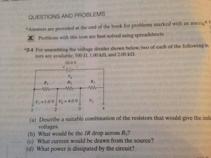

The circuit has 3 resistors in series with the voltmeter attached to contacts 2 and 4 which span resistor 2 and resistor 3.
This question is from Skoog 6th ed Instrumental Analysis textbook question 2-3.

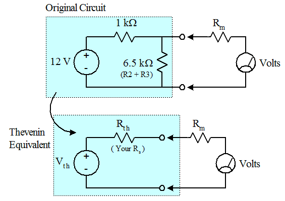

It looks to me like the source resistance Rs that you want is the so-called "output resistance" of the network that the meter "sees" when it's attached to its connection points on the network. By any chance have you studied Thevenin Equivalent Circuits yet?

I see. Well that means you'll have to read ahead a bit (the easy way!), or do a bit more work to find the result using the tools you have at hand now:
You can use your basic circuit analysis methods (KVL, KCL, etc.) to find the unloaded (open circuit) voltage across the R2+R3 combination, then the loaded (meter attached) voltage for the same. Use those values to determine the percentage change.

FYI, the Thevenin method will yield:
