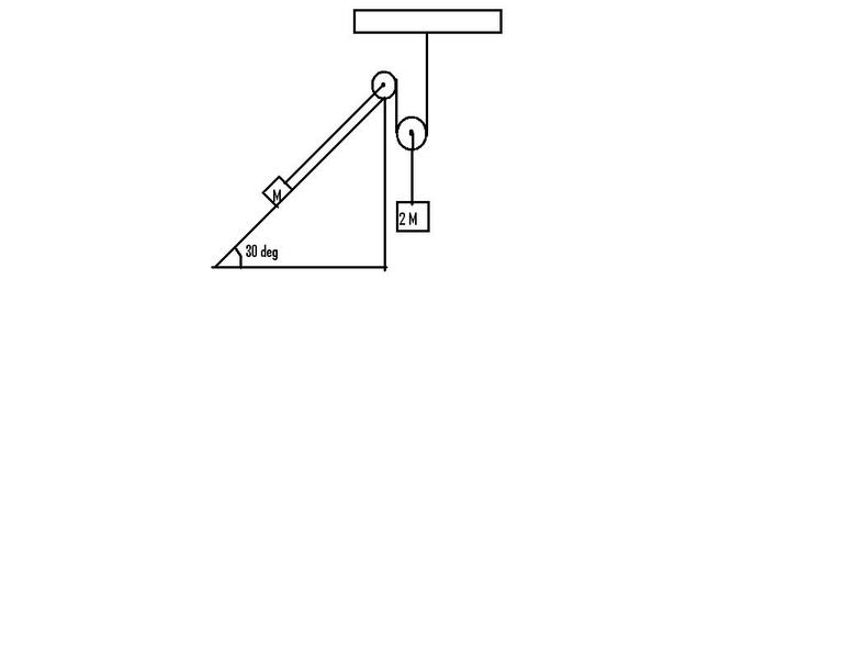

1.Homework Statement
Find the acceleration of the block of mass M in the situation shown.All surfaces are frictionless
2.The attempt at a solution
2Mg-2T=2Ma
T=Mg-Ma
and T-mgsin30=ma
But a is canceled .what to do?
T=Mg-Ma
Mg-Ma-Mgsin30=Ma
2Ma = 1/2 Mg
a= 1/4 g
Not cancelled?
Sorry, but answer given is g/3.
Acceleration of which block is denoted by ##a##? Are the accelerations the same for both blocks?
Likes 1 person
Oh,sorry.the acceleration of block 2M is a ,so acceleration of M is 2a.
Do you get the answer with that correction?
Yes sir,after Bvu's help,it is solved.
Don't understand. In the expression T-Mgsin30=Ma a is clearly the acceleration of block M, which is what is asked for. So keep it and change the acceleration of the other block to a/2, like:
(2M)g - 2T= (2M) (a/2). Bingo!
