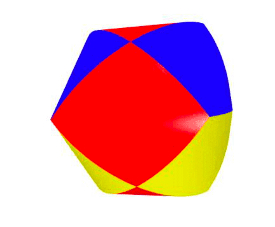

But when it comes to three intersecting cylinders I can't figure out under what and above what I have to find the volume . I have added an attachment which shows the solid that we get after intersection, but I still can not figure out how to go on? Can anybody please help to indemnify the upper and lower surfaces? Is it that my knowledge (that dividing the lower surface into small vanishing rectangles and calculating the volume of rectangular columns and then summing it up) is inadequate for this problem?

This is a rather well known problem of the Steinmetz Solid. See https://www.physicsforums.com/threads/math-challenge-by-charles-link-1.907510/#post-5716117 ##\\ ## When I solved the problem, I worked with one corner, and recognized there is, in addition, a symmetry about ## y=x ##, with the bore in the y-direction being lower than the bore in the x-direction, on the bottom side for ## y<x ##. Thereby, you work with half of a corner, and multiply the answer by 16. ## \\ ## Note: This is a slight variation of the question you were asked, but the one can be obtained from the other. It helps to draw a Venn diagram to sort out the different volumes. In your case, I believe you are asked to find the volume that includes all 3 cylinders. To do that, it might help to first find the volume common to two cylinders, etc. ## \\ ## For a Venn diagram, like the one you need for this problem, see https://www.quora.com/3-identical-c...es-What-is-the-ratio-of-the-intersection-area We are working with volumes here, but the regions representing the types of intersections of the volumes are analogous. In this problem, I believe they are asking you to compute the volume represented by ## A ## in this diagram.

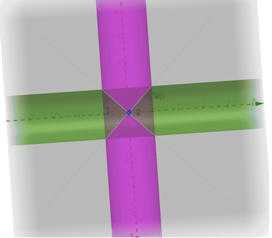

I followed your hint that there is a symmetry by [itex] y =x [/itex]. The figure which I have attached is the top view of intersection of three cylinders [itex] x^2 + y^2 = 1 [/itex] , [itex] x^2 + y^2 = 1 [/itex] [itex] y^2 + z^2 = 1[/itex] and in my figure purple cylinder is [itex] y^2 + z^2 =1 [/itex] and the green one is [itex] x^2 + z^2 =1 [/itex]
the blue lines which are scarcely visible are [itex] y=x [/itex] and [itex] y=-x[/itex]. So, following your advice I did this :-
In region the surface above ( if we look from ordinary xy plane) is [itex] z = \sqrt{1-x^2} [/itex] and the region below over which [itex] z= \sqrt{1-x^2} [/itex] lies is defined by [itex] y= -1 [/itex] [itex] y=x [/itex] and [itex] y=-x[/itex]. Therefore we need go find the volume above a region which is [itex] D = {(x,y) : -1<y<0 , y < x < -y } [/itex] and now we can go for integral that is [itex] \int_{y}^{-y} \sqrt{1-x^2} dx [/itex] and then we have to integrate this with respect to y from [itex] -1 [/itex] to [itex] 0 [/itex] which will yield an answer of (3[itex]\pi[/itex] - 4)/6. Now, region 2 will have the same volume.
What I should do next? Am I correct this far? I want to thank you for giving me your valuable time and attention.
I find it easier to write the cylinders as ## (x-\frac{1}{2})^2+(z-\frac{1}{2})^2=(\frac{1}{2})^2 ## and ## (y-\frac{1}{2})^2+(z-\frac{1}{2})^2=(\frac{1}{2})^2 ##. You then find ##V_{remaining}=16 \int\limits_{0}^{1/2}\int\limits_{0}^{x} (\frac{1}{2}-\sqrt{\frac{1}{4}-(x-\frac{1}{2})^2}) \, dy \,dx ##. I need to double-check the last double integral, but I think I got it right. Trigonometric substitution methods work for evaluating the integral. Note that the dy is simple, because there is no y dependence in the integrand. Notice also that we only needed to use the equation for the y-bore here.
And yes, I worked through the above integral again, (for the two-cylinder case), and evaluated it=it gets the correct answer. The substitution ##u=\frac{1}{2}-x ## comes in handy, and then it comes in two parts. One part requires the trigonometric substitution ## u=\frac{\cos{\theta}}{2} ##, while the other part has a simple closed form. I will be glad to give additional details if need be. ## \\ ## Putting it a bore/cylinder in the z-direction for the 3 cylinder problem for ## V_{remaining} ## makes for y limits that are from ## 0 ## to ## x ## for only part of the interval of dx from ## 0 ## to ##1/2 ##. For part of the interval, the y limits are determined by the circle ##(x-\frac{1}{2})^2+(y-\frac{1}{2})^2=(\frac{1}{2})^2 ##. In any case, the 3 cylinder problem, with bores into a cube, is readily workable as well. You can probably google the integrals, or use Wolfram, etc., but it is a good exercise to try to evaluate them on your own. :)
