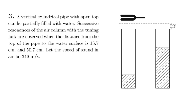

How to find the wavelength of the sound of the tuning fork?
In summary: I'm getting ahead of myself. In summary, the wavelength of the sound of the tuning fork is 4.lenght/n, the vertical distance x from the top of the pipe to the antinode above the pipe is cm, and the frequency of the tuning fork is 507 Hz.
Helly123
581
1) find the wavelength of the sound of the tuning fork (cm)
2) what's the vertical distance x from the top of the pipe to the antinode above the pipe (cm)
3) find the frequency of the tuning fork (Hz)
velocity = wavelength . frequency
for pipe closed at one end
n = 1,3,5
wavelength for n times harmonic = 4.lenght/n
I don't know for which harmonic the tuning fork exciting at 16.7 cm and 50.7 cm
I assume for 16.7 is 1st harmonic
so the wavelength = 4*16.7 = 66.8 cm
since the 50.7 approximately 3 times 16.7, I assume that the n value is 3, which is the 2nd harmonic
so the wavelength = 4*50.7/3 = 67.6 cm
so the wavelength is 67 cm??
2) can you give me clue, where to start?
3) f = v / wavelength
f = 340 / 0.67 m = 507 Hz

for number 1 the right answer is 68 cm.. why? which column length to be taken?
No need to make that assumption. Let it be the nth harmonic.
Even if it is the first harmonic, that is not right. Where is the known antinode in relation to the known node?

The 0.6 times pipe radius you refer to is usually referred to as the end correction...but you don't need to know its value for this problem. You do, however, need to know that an antinode appears at a total height equal to length of tube plus length of end correction. All should become clear if you draw sketches showing the wave profiles for two succesive resonances and marking in the positions of the nodes and antinodes.

Thanks for all replies. Sorry, i have problem opening this forum before..
I think i get it from internet that
L1 + end-correction = lambda/4
While
L2 - L1 = lambda/2
Using those equations i can find the answer
The open end side of pipe start with antinode
While the closed end side ended with node
While
L2 - L1 = lambda/2
Right. And presumably you also got L2 + end-correction =3 lambda/4.

Do you understand the concept of an end correction at an open end of a pipe?
yeah.. End correction = 0.6 * pipe raduis as stated above ...
That's a rough guide but need not be exact in all cases. In the given question it can be calculated from the data.
But I was asking if you understood the concept, not how to calculate it.
The advice of penguin & others to sketch diagrams is EXCELLENT. I do it for anything but the most trivial questions.
But the answer here is in the wording of the question, "Successive resonances of ..."
Nodes are always ##\frac {λ}{2}## apart, as are antinodes. (As you would see in sketches.)
So the distance between successive resonances are also ##\frac {λ}{2}## apart
And that would be equally true for pipes open at both ends.
End correction is an interesting issue and you should be aware of its existence, but is not IMO essential to parts 1 and 3, nor even to answer part 2, though you might be puzzled by this if you were unaware.
