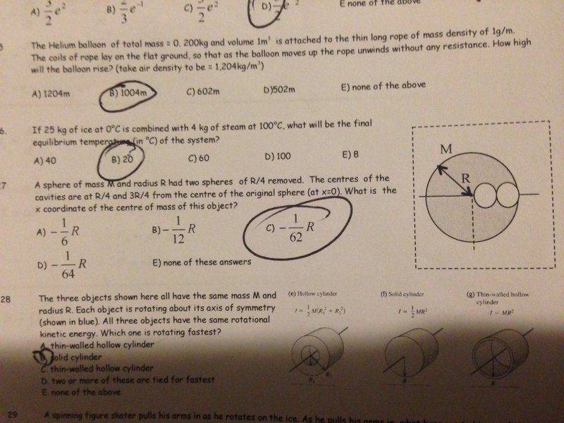

A sphere of mass M and Radius R had two spheres of R/4 removed. the centres of cavities are R/4 and 3R/4 from the centre of the original sphere (at x=0). what is the x coordinate of the centre of mass of this object?
there is a drawing next to the question literally showing the cavities on the right side of the circle nothing else so i did not include it with the question.
none, but the answer given is -1/62 x R
I have absolutely no idea where to start with this problem. I used the Xcm equation but it didnt work and I have done a similar problem but that one had mass and radius given so now this confuses me. any help or procedure would be helpful (this is a practice final [final is in 2 days]).

I'm confused. The original problem talked about a sphere of mass M and radius R with two smaller spherical cavities removed, each with radius R/4.
Now, we're talking about a circle of radius R with two smaller circles removed. Which is the correct problem?
I suspect that you can't use a circle in place of a sphere and get the answer for x-bar as disclosed in the OP. :frown:
Oh i see what you mean... the diagram next to the problem shows a 2-D Circle not a sphere yet the problem lists sphere...
In that case i guess let's assume it was a typo and the original was a circle. If the answer is incorrect i should be able to follow the same format for the solution albeit with different formulas for area (which would change M as well i guess...)
My prof has a habit of messing up his problem questions haha
I've never see this diagram. It's not attached to any of your posts.
The answer in the OP for the location of x-bar can be shown for spherical cavities within a larger sphere. I suspect the same answer cannot be shown when using circles in place of spheres.

I have added the diagram with the OP. Will i have to change my approach now?
Yes. The problem statement clearly says 'sphere' not 'circle'.
You're taking the diagram much too literally. If you want to show a sphere in a two-dimensional sketch, most people understand that a circle can be used in place of, IDK, a hologram.
Now to get back on track with solving this problem, in Post #2, ehild suggested how you might determine the amount of mass removed from each of the small cavities in the large sphere. You are given the radius of the large sphere as R and its mass before the cavities removed as M. Is there some physical property of 3-dimensional bodies which involves mass and volume that could be used to calculate the amount of mass removed from the cavities?

Well assuming the original sphere has a homogeneous density based on its mass and volume, you should be able to calculate the amount of mass removed from each cavity, using that density and the volume of the cavity. Mind you, this is mostly an exercise in algebra, since you know no numerical values for R or M.
So set M/V = M'/V' and solve for M'...
Take 0- Xcm of the two circles / M-M'
That works?
That works?
It's more like ρ = M / V = density of the sphere before the cavities are removed.
Then, after calculating V' = volume of each cavity, M' = ρ ⋅ V' = mass removed from each cavity.
Once you know M' for each cavity, you are given the centers of each, so you can calculate the location of Xcm knowing the net mass of the sphere with the two cavities removed and by calculating the moment of the net mass of the sphere about the y-axis.

Oh okay i think I understand now! thank you so much you guys really were a huge help
