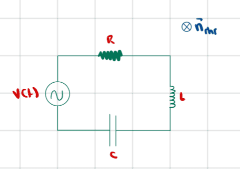

Given a series RLC circuit (pictured below), find the voltage across the capacitor.
Assume that ##V(t)=V_0\sin{(\omega t)}##.
By Faraday's law
$$-V(t)+I(t)R+\frac{q(t)}{C}=-L\dot{I}(t)\tag{1}$$
$$\dot{I}+\frac{R}{L}I+\frac{1}{LC}q=\frac{V(t)}{L}\tag{2}$$
Here we can either form a differential equation in ##q(t)## or we can differentiate and form one in ##I(t)##.
These equations are
$$\ddot{q}+\frac{R}{L}\dot{q}+\frac{1}{LC}q=\frac{V(t)}{L}\tag{3}$$
$$\ddot{I}+\frac{R}{L}\dot{I}+\frac{1}{LC}I=\frac{\dot{V}(t)}{L}\tag{4}$$

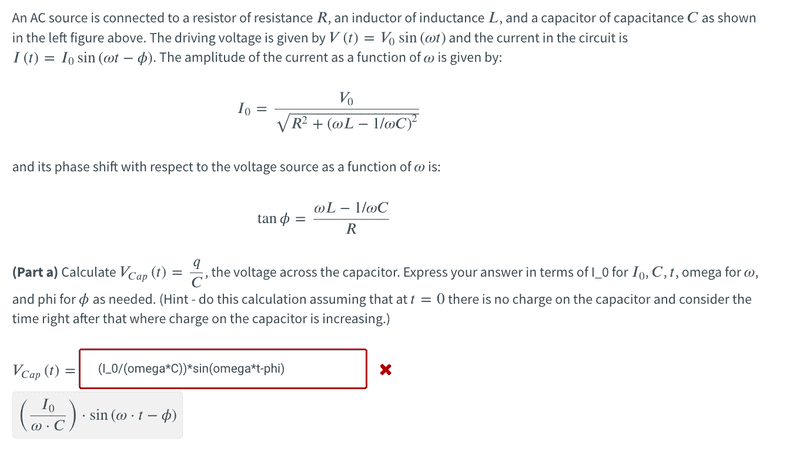

In MIT OCW's 8.02 there is the following question
Calculate ##V_{cap}(t)=\frac{q}{C}##, the voltage across the capacitor. Hint: do this calculation assuming that at ##t=0## there is no charge on the capacitor and consider the time right after that where charge on the capacitor is increasing.
I am really not sure how to take this hint into account.

As you can see below, the automated grading system for this question tells me I am wrong
For the record, this problem also asked a few questions about the phase lag between current, ac voltage and voltage across the capacitor. I answered these successfully, and here is my analysis

One other thing I tried to do to find the capacitor voltage (while taking into account the hint) was to try to force ##q(0)=0##.
After all, if the AC voltage is ##V_0\sin{\omega t}## then at time zero this voltage is zero but the charge on the capacitor is not since there is a phase lag and so the sine in the expression for ##q(t)## is not zero.
If the AC voltage is instead ##V_0\sin{(\omega t+\theta)}## then
$$q(t)=\frac{I_0}{\omega}\sin{(\omega t+\theta -\phi)}$$
and
$$q(0)=\frac{I_0}{\omega}\sin{(\theta-\phi)}=0$$
$$\implies \theta=\phi$$
so that now
$$q(t)=\frac{I_0}{\omega}\sin{(\omega t)}$$
and
$$V_c(t)=\frac{I_0}{\omega C}\sin{(\omega t)}$$
But this is also incorrect in the automated grader.
Something is missed.
