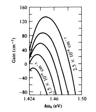

How to get plot (optical gain of GaAs)?
In summary, to calculate the plot of photon energy dependence of the optical gain (or loss) of GaAs with the injected carrier density as a parameter, we need to use the equation G = (n2ω0/c)([ƒc(ω)-ƒv(ω)]/T2)e^(-2πħω/Eg)e^(-taung/T2) where n is the refractive index, ω0 is the angular frequency of the light, c is the speed of light in vacuum, ƒc is the Fermi-Dirac distribution function for electrons in the conduction band, ƒv is the Fermi-Dirac distribution function for holes in the valence band
yeyintkoko
How can i calculate this plot (photon energy dependence of the optical gain (or loss = negative gain) of GaAs with the injected carrier density as a parameter?
Show calculated plot based on this equation
Given parameter:
mc=0.067 me; (effective mass of electrons in conduction band)
mv=0.48 me; (effective mass of holes in valence band)
T2~0.5 ps; (lifetime for coherent interaction of electrons with a monochromatic field)
Eg=1.43 eV; (energy band gap of GaAs)
taung~3x10-9s; (recombination lifetime)
1/mr=1/mc+1/mv; ( reduced effective mass)
n= 3.6: (refractive index for GaAs)
How can i find this value
ħω (energy of photon)- this should be ħω>Eg. How can i determine this energy?
λ0
ω0 ( if i known λ0, can i get ω0? (ω=c/λ))
c(ω)-ƒv(ω)]
Really I need your help. I am new for semiconductor laser. Please anyone help me.
Thanks!
The equation for the optical gain (or loss) of GaAs with an injected carrier density as a parameter is given by: G = (n2ω0/c)([ƒc(ω)-ƒv(ω)]/T2)e^(-2πħω/Eg)e^(-taung/T2)where n is the refractive index, ω0 is the angular frequency of the light, c is the speed of light in vacuum, ƒc is the Fermi-Dirac distribution function for electrons in the conduction band, ƒv is the Fermi-Dirac distribution function for holes in the valence band, T2 is the lifetime for coherent interaction of electrons with a monochromatic field, ħω is the energy of the photon, Eg is the energy band gap of GaAs, and taung is the recombination lifetime.To calculate the plot of optical gain (or loss) as a function of photon energy, we need to determine the value of ħω (energy of the photon). This value should be greater than Eg, and can be determined from the equation ħω = hc/λ where h is Planck's constant, c is the speed of light in vacuum, and λ is the wavelength of the light. Once the value of ħω is known, the optical gain (or loss) can be calculated for each value of ħω using the equation given above. The resulting plot of optical gain (or loss) as a function of photon energy can then be plotted. Please note that the calculation of the optical gain (or loss) will also depend on the injected carrier density, which needs to be specified in order to obtain the correct results.
