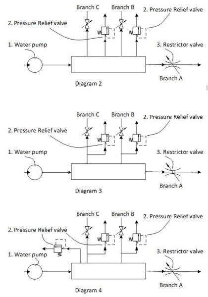

I am discussing with my friends to see which way is the best way to get the most stable branch outputs when one branch condition changed suddenly.

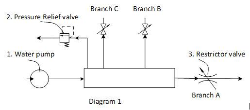

There are three liquid flow branches, A, B and C, connected together with one pressure source, like this configuration:
The Water Pump, #1, guarantees to provide the pressure of 200 bar to the system. The Pressure Relief Valve, #2, will be set to 195 bar and assume it will open to relieve the extra pressure when the pressure is over that value. Branch A, B and C are all expected to have a pressure of 195 bar to work properly.After the system is in perfect working condition, we manually change the Restrictor valve, #3, to make more resistance in Branch A. We assume the change is NOT small. Then the system pressure may increase immediately due to the change from Branch A. But the increase may be relieved by the Pressure Relief valve, #2, immediately, as well.Now there are two different opinions for the result of the change from Branch A:Opinion 1: Branch B and Branch C will not be affected, because the Pressure Relief valve is three for this purpose.
Opinion 2: Branch B and Branch C will be affected, because the Pressure Relief valve is far from the change source and the change reaches Branch B and C first.Q1: What is your opinion about this?
Because of above different opinions, there are more configurations come out:
Q2: Which configuration is the best configuration in order to get the most stable working pressure for Branch B and C?NOTE: let's only focus on pressure increase here for now.

You need to calculate the line losses for the extreme operating conditions. Those conditions include, but are not limited to, all flow through A, all flow through the PRV, maximum flow through B, maximum flow through C. If constant pressure under transient conditions is important, you need the maximum rate of change of the valves at A, B, and C, plus the transient response of the PRV. Is the water pump a multistage centrifugal or positive displacement pump?
Then, and only then, you can start to look at solutions.

Everything about this setup and question is odd:
  • Why are you using a pressure relief valve for control? Usually they are for safety. Using something not meant for control, for control, seems like a bad way to achieve stable control.
  • Why are you changing the position of valve #3? In response to what?
  • Are you really interested in the pressure at valves B & C or the flow rate?
  • Is there any control in this system other than the relief valve and valve #3? If not, why not?
The purpose of a header is to ensure the pressure is equal to everything connected to the header. If it isn't, it is usually because it is undersized. If it's a transient condition you are worried about - essentially the time the pressure change requires to propagate through the system at the speed of sound in water- that's an incredible level of required precision/responsiveness...and by the way, you didn't actually say what your requirements in terms of flow rate, accuracy and responsiveness are.
The last one, but I doubt even it would give a stable pressure. Relief valves don't modulate, they go open/closed, so what I foresee with all is the pressure jumping up and down wildly as the relief valves snap open and closed repeatedly.

If I want to make Branch A, B and C all the same having a stable flow rate and also minimize the possible impact from each other, what should a professional configuration look like?
Active volume control by each valve and pressure control in the header by the pump. This require pressure and flow sensors and feedback control.
Likes happylearner and anorlunda
Thank you, Russ.
If I want to allow one of the branches leave and join occasionally, how to minimize the possible impact on other branches? One active volume control on each branch can handle this?
