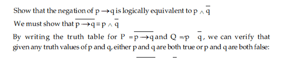

Suppose that the compound proposition p is made up of
propositions p 1 ... p n and compound proposition q is made up of propositions q 1 ... q n , we say that p and q are logically equivalent and write it as p ≡ q
provided that given any truth values of p 1 ... p n and truth values of q 1 ... q n , either p and q are both true or p and q are both false.

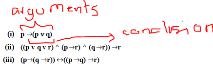

Here's the question : Which of the following are tautologies? If the statement is a tautology, give a proof using the appropriate rules of logic. (Avoid using truth tables if possible.) If it is not a tautology, then justify your answer by giving an appropriate example for the following questions below :

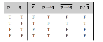

Henry R said:
p v p is an example of tautology
P ^ P is an example of contradiction
These must mean $p\lor\bar{p}$ and $p\land\bar{p}$.
Have you figured this out using truth tables or common sense? For the first formula, is it true that $p$ always implies $p$ or $q$? For the second one, suppose that if you are free, then you go to the movies, and if you are busy, you also go to the movies. If it is known that you are either free, busy or went to the movies, does it follow that you are watching a movie?
The set of appropriate rules of logic differs from one textbook or course to the next. It would be nice if you listed them.
