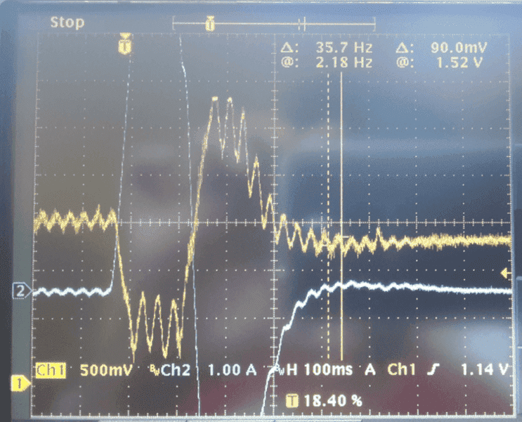

Hello,
I have a state space equation at hand.. This attached with this...
Now the term (theta double dot) is a positive step for 0,136 milli seconds and negative step for next 0,136 millisecond and 0 at all other times.
So that when I simulate I will get a graph as below:
This is the nature of the graph I am expecting.
Iam using Matlab ODE45 to solve this. It is pretty easy I think, but I can't figure out how to give this acceleration function.

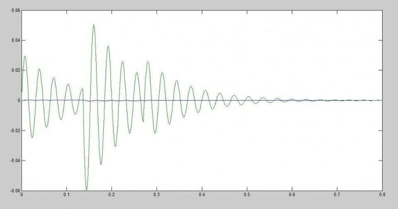

The code I used and the results are attached here. Obviously its wrong. The expected nature of the curve is like the one shown in the first post( the oscilloscope display). Please help if anyone knows.
