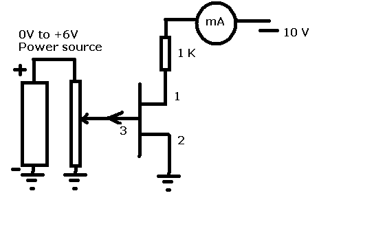

A FET is a field effect transistor. The resistance between the drain and the source (wire 1 and 2) changes depending on the voltage on wire 3, the gate.
Usually, most circuits use a N-Channel type which requires a positive power supply. This one looks like a P-Channel one which requires a negative power supply. These are rarely used, but some special circuits require them.
You could test it like this:
If the variable power source (on the left in the diagram) is set to zero volts, the current shown on the meter would be a maximum. As you made the gate more positive, the current in the meter would decrease. If there is enough voltage on wire 3 the current will drop to zero.
1 and 2 can be reversed and the FET will work better one way than the other. You can try this. Look for the connection that requires least voltage on wire 3 to cut the meter current to zero.
