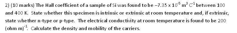

please see attached image for problem
if a dopant gives an electron it's an n-type, if a dopant takes an electron it's a p-type.
i can't see how to relate the hall coefficient value to the property of being a n-type or p-type semiconductor?
any pointers on this would really be appreciated, thanks

Electrons flowing in one direction will get deflected in the same direction as holes flowing in the opposite direction - for one doping type you get negative electrons at one side, for the other doping type you get positive holes at this side. This leads to a different hall coefficient.
Likes 1 person
The Hall Coefficient is:
RH = [itex]\frac{1}{nq}[/itex]​
For electrons, q= -e, and our hall coefficient is:
RH = [itex]\frac{-1}{ne}[/itex]​
Therefore we know that n-type semiconductors have negative RH.
Likes 1 person
hm so simple, many thanks!
