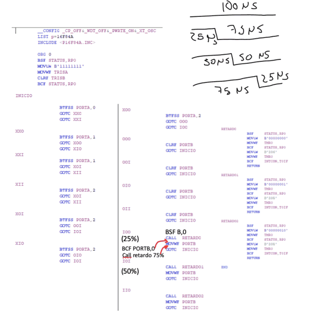

I have some problems with my code, which is to control the speed of a DC motor by pwm with the pic16f84A.

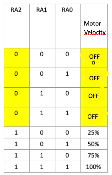

I already have the combinations and the diagram of the signals, but I still need to implement the part in bold.
How would the delays be implemented so that they have 25 us, 50 us, 75 us according to the diagram? I do not understand that part ;(
The time per cycle is 100 microseconds

If this is free running code, without interrupts, then three of the states will need two delay loops.
Declare a register called State, read RA into state
State = State AND 0h07 mask high five, keep only three lowest bits
There are 5 cases.
If State(bit2) = 0 then turn off; wait 100u; end
If State = 00 then turn on; wait 25; turn off; wait 75; end
If State = 01 then turn on; wait 50; turn off; wait 50; end
If State = 10 then turn on; wait 75; turn off; wait 25; end
If State = 11 then turn on; wait 100u; (turn off?); end

Oh, i now understand the times. Yes, the output to the motor can be any bit of the PortB.
I would write straight code with unconditional equal delays
label Cycle; it will get back here every 100 usec
read PortA into state
State = State AND 0h07; mask high five, keep only three lowest bits
If state(bit2) = 1 then turn on motor
delay 25 usec
if state = 0b100 then turn off motor
delay 25 usec
if state = 0b101 then turn off motor
delay 25 usec
if state = 0b110 then turn off motor
delay 25 usec
turn off motor here only if needed?
Goto cycle

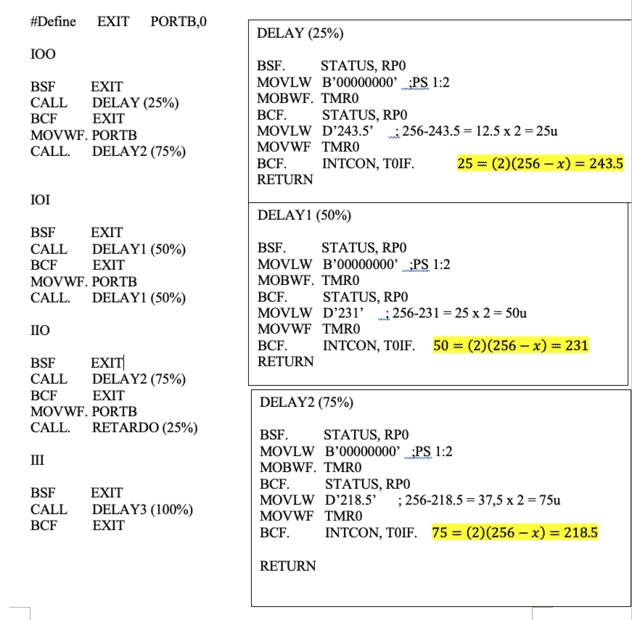

The code its like this?

You did not understand the straight code with unconditional equal delays. There are 4 delays of 25 usec in the loop. The total delay is therefore the loop period of 100 usec. If active, the motor is turned on at the start, then turned off after the appropriate delay, depending on the state of portA.
There are a couple of tricks needed to keep it compact. Also, the 50% state might better be done with [on-off-on-off], rather than [on-on-off-off].
I will see if I can write some PIC16F84 code tomorrow.
Attached is untested code for 100 usec state machine loop.
You will need to make the delay 25 usec routine.

25 usec is probably too short to be done efficiently with a timer.
An in-line delay might be more appropriate, then you can trim the number of cycles.
With a 4 MHz clock the instruction time is 1 usec.
Cblock ; assign delay variable to next available register in file
count
endc
; this is the tight in-line loop that does not use a timer
; Delay(25) start with a number that will make up to the 25 usec
movlw 12; adjust the start count
movwf count
decfsz count, f
goto $-1
; count is now zero, pad with a NOP if you need 1 usec more
I have been thinking about the state conversion.
Your table of 3 bit codes;
0 x x = 0%
1 0 0 = 25%
1 0 1 = 50%
1 1 0 = 75%
1 1 1 = 100%
Can be converted to 4 columns by duplicating the middle column, onto the right;
0 x x = 0 x x x = 0%
1 0 0 = 1 0 0 0 = 25%
1 0 1 = 1 0 1 0 = 50%
1 1 0 = 1 1 0 1 = 75%
1 1 1 = 1 1 1 1 = 100%
Notice how these 4 bits are now arranged so the number of bits set, is correct for the duty cycle.
To generate the motor PWM you only need output those 3 bits at the appropriate 4 times.
It is simplest to select PortB, bit 1, as the motor output.
