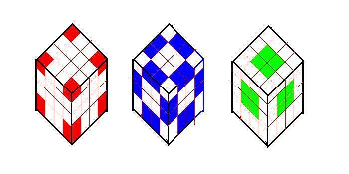

Are there any blocks with no sides painted? Where are they located? What shape to they make? How many blocks have no side painted?
Are there any blocks with exactly one side painted? Where are they located? What shape do they make? How many blocks have exactly one side painted?
I am not able to completely vizualize the problem..The small cubes which are cut from the corners of the big cube will have 3 sides painted(they will be 8 in number).Also the small cubes which lie on the edge will have 2 sides painted while the cubes taken from the middle part of the bigger cube will have no sides painted..That's all..Unalbe to count the exact number of cubes which have one or two side painttedBelieve me,I have put in some serious efforts to solve it,But just unable to completely vizualize it..

In any 3D problem, look for a way to reduce it to a smaller dimension problem.
In this particular case, you need to consider the faces of the cube, which are 2D.
Draw it if you cannot visualise it. An isometric sketch of a cube (one with a corner towards you) will give you an idea of how to approach it.
Also: Khaaaaaaaaaaaaaaaaaaaaaaaaaaaaaaan!
(That isn't relevant - sorry).
Ibix is right: make a sketch. See attached one.
It is a 4x4x4 cube. All the outside ones are painted at last on one side.
There are 8 corner-cubes, painted on 3 sides.
All edges have two corner cubes, so there are 4-2 cubes which are painted on two sides for each edge. There are 12 edges: 24 cubes painted on two sides. How many are there for an NxNxN cube?
On each side of the big cube there are 4x4 small cubes. If you remove the edge-cubes and corner-cubes, you have a 2x2 square, 4 cubes painted on one side only. There are 6 sides of the big cube: 6x4=24 small cubes painted on one side. How many are there in case of an NxNxN cube?
The number of painted cubes is 8+24+24=56.
If you "peel off" all the outer layers of painted cubes, you get a cube with edges of 2 units, a smaller cube of size 2x2x2=8. How many do you get for an NxNxN cube?
The number of all small cubes, painted and not painted is 56+8=64 =4x4x4, as it should be.
