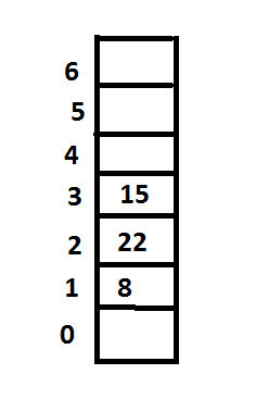

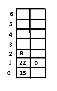

There are given three elements with keys $22, 15, 8$. Insert them in the given order in a hashtable of $7$ positions given that as method of treatement of the collisions we use:
  • hashing that follows the method coalesced chaining with the hash fuction $h(k)=k \mod m$
  • ordered hashing with open addressing strategies with the primary hash function $h_1(x)=x \mod m$ and the secondary hash function $h_2(x)=(x^2+1) \mod{7}$
That's what I have tried:
For the first case:
For the second case:
View attachment 3895Could you tell me if it is right? (Thinking)

I believe the first case is right. (Nod)
In the second case, the first value of 22 would still be inserted in slot 1 (using the primary hash function), so I think 22 should be there instead of 8. (Shake)
Did you figure it out? (Wondering)
Yes, I did.. Thanks for your answer! (Smile)
