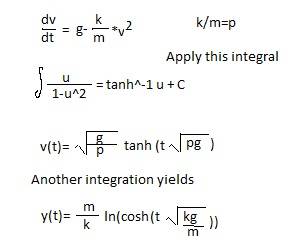

I have been unable to solve this problem featured in "Elementary Differential Equations" by Edwards and Penney. The problem is this: I do not know how to integrate the function, and get the desired result. I would very much appreciated any help and instructions on how to get the two air resistance equations by integrating the function.

The ODE can be written with the variables v and t separated as...
$\displaystyle \frac{d v}{1 - \frac{k}{m g}\ v^{2}} = g\ d t$ (1)
... and remembering that is...
$\displaystyle \int \frac{d u}{1-a\ u^{2}} = \frac{\tanh^{-1} (\sqrt{a}\ u)}{\sqrt{a}} + c$ (2)
... You obtain...$\displaystyle \tanh^{-1} (\sqrt{\frac{k}{m\ g}}\ v) = \sqrt{\frac{k\ g}{m}}\ t + c $ (3)
... and from (3)...
$\displaystyle v = \sqrt{\frac{m\ g}{k}} \tanh (\sqrt{\frac{k\ g}{m}}\ t + c)$ (4)
Now You can proceed if You are able to find the constant c and that is possible if the initial speed v(0) is given... Kind regards $\chi$ $\sigma$

So you have
$$\frac{1}{g} \, \frac{dv}{dt}=1- \frac{k}{mg}\,v^{2}$$
$$\int \frac{dv}{1- \frac{k}{mg} \,v^{2}}=g \int dt$$
$$ \frac{ \tanh^{-1} \left( \sqrt{ \frac{k}{mg}} \, v \right)}{ \sqrt{ \frac{k}{mg}} }=gt+c$$
$$\tanh^{-1} \left( \sqrt{ \frac{k}{mg}} \, v \right)= \sqrt{ \frac{k}{mg}}\, (gt+c)$$
$$\tanh^{-1} \left( \sqrt{ \frac{k}{mg}} \, v \right)= \sqrt{ \frac{k g^{2}}{mg}}\,t+\sqrt{ \frac{k}{mg}} \, c= \sqrt{ \frac{kg}{m}}\,t+c'.$$
Can you continue from here? Note that a constant times an arbitrary constant is just another arbitrary constant - in DE's, you often absorb known constants into arbitrary constants, and relabel as the original arbitrary constant. So the $c'$ above becomes $c$ again.
Thank you very very much you have been a great help!
