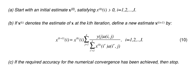

okey, a more accurate situation:
we have
A =
[[ 5. 2. 3. ]
[ 0.4 0.1 5. ]
[ 5. 0.4 0.2]
[ 0.3 0.2 10. ]
[ 1. 0.3 2. ]
[ 0.3 0.7 0.4]]
b =
[[ 2. ]
[ 0.1]
[ 0.4]
[ 0.2]
[ 0.3]
[ 0.7]]
and we are looking for x that satisfies Ax =b .
In this situation the MLEM works very good and the x is found : [0 1 0]
now suppose we have an A, that is equal to :
A =
[[ 5. -2. 3. ]
[ 0.4 0.1 5. ]
[ 5. 0.4 0.2]
[ 0.3 0.2 10. ]
[ 1. 0.3 2. ]
[ 0.3 0.7 0.4]]
so we just took -2 instead of 2 .
b =
[-2. ]
[ 0.1]
[ 0.4]
[ 0.2]
[ 0.3]
[ 0.7]]
although there is a solution , which is [0 1 0], The MLEM doesn't work anymore and we are not able to find the x (because of the negative element -2 in A).
So my question is: if A has negativ elements, how can I transform the situation to find the x like in a MLEM Algorithm ?
I hope it is clear now :)
THANK YOU
Stephen Tashi said:
Do the remarks in Byrne's paper "2. From general kernels to non-negative ones" apply to your problem?
The MLEM is to be seen in the picture uploaded, where aij are the elements of the matrix A and y is to be considered b in our case,.

The example still leaves the general problem unclear. Is your general problem to solve an "overdetermined" system of equations? - or to solve a system of equations that has a unique solution?
You example has 6 equations and 3 unknowns. But you've chosen numbers so the system has an exact solution.
If you are solving a system of equations that has a unique solution, you can transform the equations by doing "row operations" without altering the solution. For example: multiply row 6 by 10 and add it to row 1:
So ##(5. -2. 3.)## is changed to ## (5. +(10)(.3) ,\ -2. +(10)(. 7),\ 3. + (10)(.4) ) = (8., 5., 7.) ##
If you are solving a system of "overdetermined" equations, then a solution is defined as a value x that minimizes a certain measure of "error" between Ax and b. What measure of error are you using? Is it ##|| Ax - b||^2 ## ? - i.e. x the "least square error" solution ? The measure of error must be considered because a row operation might not preserve the solution.
