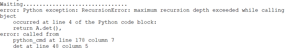

Calculating determinants of large matrices is inefficient. One option is to use det(sym(data)), but that might take too long to execute, or throw errors with floating point data. I tried using it in Octave, and after waiting for a long time, I got an error:
Matlab might have performed better.

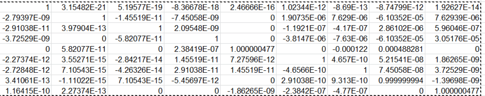

Funny, with excel MDETERM I get the same determinant
2.327477552992E+52
The M_RANK function in http://web.bowdoin.edu/~rdelevie/excellaneous/#downloads returns a clear 9
And MINVERSE gives me an inverse without problems.
So all OK ? Don't know for sure: Multiplying the two with MMULT does show defects of size 10-4, so it seems there is something sensitive:
don't know how to hide things so use spoiler: here are the numbers.
Code:
1    3.15482E-21    5.19577E-19    -8.36678E-18    2.46666E-16    1.02344E-12    -8.69165E-13    -8.74799E-12    1.92627E-14
-2.79397E-09    1    -1.45519E-11    -7.45058E-09    0    1.90735E-06    7.62939E-06    -6.10352E-05    7.62939E-06
-2.91038E-11    3.97904E-13    1    2.09548E-09    0    -1.19209E-07    -4.17233E-07    2.86102E-06    5.96046E-07
-3.72529E-09    0    -5.82077E-11    1    0    -3.8147E-06    -7.62939E-06    -6.10352E-05    3.05176E-05
0    5.82077E-11    0    2.38419E-07    1.000000477    0    -0.00012207    0.000488281    0
-2.27374E-12    3.55271E-15    -2.84217E-14    1.45519E-11    7.27596E-12    1    4.65661E-10    5.21541E-08    1.86265E-09
-2.72848E-12    7.10543E-15    -4.26326E-14    2.91038E-11    1.45519E-11    -4.65661E-10    0.999999994    7.45058E-08    3.72529E-09
3.41061E-13    -1.11022E-15    7.10543E-15    -5.45697E-12    0    2.91038E-10    9.31323E-10    0.999999994    -1.39698E-09
1.16415E-10    2.27374E-13    0    0    -1.86265E-09    -2.38419E-07    -4.76837E-07    0    1.000000477
