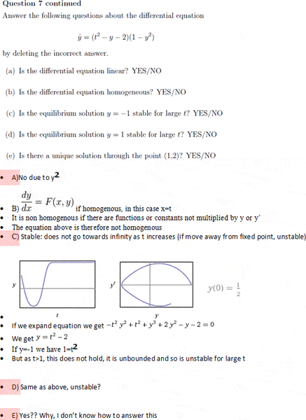

?How to know if equilibrium points are stable or not. Is my solution correct
In summary, the equilibrium points -1 and 1 are stable and unstable, respectively, for the function y= t^2- y- 2. When y is close to either -1 or 1, the function is positive, meaning that y' is positive and y is increasing or decreasing towards the equilibrium points. Depending on the starting value of y, it will either tend towards -1 or away from 1, indicating that -1 is a stable equilibrium point and 1 is an unstable equilibrium point.

ok i followed what your saying. can you tell me if my solution below is correct? for part c and d
i said C is stable, and so is D
It would be helpful if you pasted the text into the reply text box instead of uploading a scanned image. A scanned image makes it harder for responders such as myself to identify a particular line. I have to identify the line where there's a problem, and then point out what the problem is.
For c) you said "A fixed point is stable, if when we sub values from either side of the fixed point, we see that the gradient y', are opposite symbols."
This is not true.
From a previous thread, you gave a definition of stability that involved the second derivative. If xc is a fixed point (i.e., f'(xc) = 0), xc is stable if f''(xc) > 0. xc is an unstable fixed point if f''(xc) < 0.
In terms of the first derivative, if xc is a fixed point, xc is a stable fixed point if the derivative f' changes sign from negative to positive, moving left to right. xc is an unstable fixed point if the derivative f' changes sign from positive to negative, moving left to right.
It is not enough to notice that the derivative changes sign. It has to change sign in a certain way for the fixed point to be stable fixed point, and it has to change sign in the opposite way for it to be an unstable fixed point.

you said (1-y)^2=(y-1)(y+1)
but that is false
(1-y)^2=-(y-1)(y+1)=(1-y)(y+1)
see here: http://www.wolframalpha.com/input/?i=%281-y^2%29
so doesn't that mean your solution is wrong?

HallsOfIvy, you are mistakenly working with y2 - 1 instead of 1 - y2, so some of your results have the wrong sign.

You mean 1-y2 = (1-y)(1+y), not (1-y)2, which equals 1-2y+y2.
The only thing that does is flip some of the signs in HallsofIvy's analysis. If you understand what he said, you should be able to tell us how that changes the conclusions, if it does at all.

y'=-(t^2- y- 2)(y- 1)(y+ 1)
-1<y<1 for large t, y' is positive
y<-1 for large t,y' is negative
y>1 for large y, y' is negative
<==-1==>1<==
so y=1 is a stable, y=-1 is unstable
but isn't this just the same as my method in post 3, except a small error.
all i have learned here is that lower values than the fixed point must give a positive gradient. and higher values must be negative gradient
I think of a negative y’ as <== and positive y’ as==>. Then if we have ==><== at either side. Is stable. is this correct?
<==-1==>1<==
Right. In your solution, you should probably explain how you determined the sign of y' in the three regions.
I wouldn't say you made a small error. You had a conceptual error about the difference between a stable and unstable fixed point. Considering the problem was about identifying exactly this characteristic of the fixed points, I'd say it was a major error.
Lower and higher values of what?
Yes, it's correct. Can you explain why you think of y'<0 as <== and y'>0 as ==>?
no. but i guess i have to explain that in the exam. why is it?
i just thinking of positive as moving forwards, thus ==>
and negative as moving backwards, thus <==
At this point in your education, your instructor probably assumes you understand this concept, so you don't need to explain it on an exam. You should be able to explain it, however. If someone were to ask you why y'>0 means ==> as opposed to <==, you should be able to give a reason better than "it gives me the right answer when I assume that" or "that's what someone else told me."
ok, i am very grateful for your help. i have my exam in 3 days.
can you please kindly tell me how do i answer part e. wether there is a unique solution through the point (1,2).
i know that to prove uniqueness, we must have y'=f(t,y), and differentiate w.r.t to y. i.e find (f(t,y))'
and then show that (f(t,y))' is continuous.
to show whether or not it has a unique solution at (1,2), should i sub t=1 and y=2 into (f(t,y))', and if i get a unique solution. does that mean there is a unique solution through the point (1,2)??
Aren't you skipping a step? You have y' = f(t, y) = (t2 - y - 2)(1 - y2).
For there to be a unique solution at (1, 2), both f and fy have to be defined and continuous on some rectangle around (1, 2). The part that you seem to have skipped is finding
[tex]f_y = \frac{\partial }{\partial y}f(t, y)[/tex]
First y’’=-2(t^2-2)y+3y^2-1,
http://www.wolframalpha.com/input/?i=-%28t^2-+y-+2%29%28y-+1%29%28y%2B+1%29
at t=1 and y=2, we get that the only solution is 15. So the point (1,2) gives a unique solution, as required
http://www.wolframalpha.com/input/?i=-2+%28t^2-2%29+y%2B3+y^2-1%2C+t%3D1%2Cy%3D2
is my solution correct?
No, this isn't even very close.
y' = f(t, y) = (t2 - y - 2)(1 - y2). Here, y' means dy/dt.
To calculate fy, which in different notation is
[tex]\frac{\partial f}{\partial y}[/tex]
you need to use the product rule. I think you might have done this, but what you got is incorrect.
This isn't about solutions or unique solutions. All you need to do is confirm that f(t, y) and fy(t, y) are continuous in some rectangle around the point (1, 2).
No. See above.
No. See above.
I did differentaite w.r.t y, see wolfram
then i sub t=1 y=2 and got 15
Apologies, your derivative was correct. Your notation was not so good, though.
If y' means dy/dt, then y'' means d2y/dt2, and that's not what is called for here. Instead of y'', you should use fy or other notation to indicate that you're taking the partial with respect to y.
The object isn't merely to evaluate f(1, 2) and fy(1, 2). You need to show that f(t, y) and fy(t, y) are continuous in some rectangle around (1, 2). Can you do that?
  • #31
Fy=-2(t^2-2)y+3y^2-1
i have no idea how to show this is continuous?
is there a method. if so i don't know what it is, cany you give me a link to a website which possibly teaches you how to know if somethig is continous.
i know how to prove a function is 1-1 though
  • #32
Both functions are defined at all point (t, y) in the plane. Since the only operations involved in their formulas are multiplication and addition, both functions are also continuous at every point (t, y) in the plane.
The basis ideas involved here are these: if g(x) and h(x) are continuous functions, the the sum (g + h)(x) and product gh(x) are continous. both f(t, y) and fy(t, y) can be split up into the sum or product of simple linear or quadratic functions, which is enough to show that f(t, y) and fy(t, y) are continuous. This is enough to show that the differential equation y' = f(t, y) has a unique solution that contains the point (1, 2). That's what you wanted to show in part e, so you're done.
